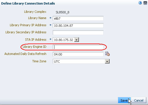

In the Define Library Connection Details dialog box, blank out the Library Engine ID field, and then click Save. This will force STA to update the engine ID to the new value when it reconnects to the library.

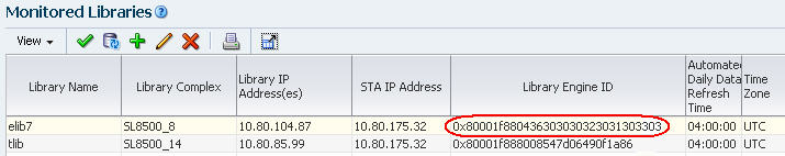

This is the new SNMP engine ID for the library, and you will use it in “Update SNMP Settings on the Library”, Step 4.
