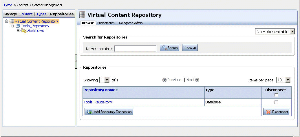

In the resources tree, select the Virtual Content Repository to see a list of repositories in the Browse tab.
In the Browse tab, select the Disconnect check box for the repository you wish to disconnect.
Click Disconnect.

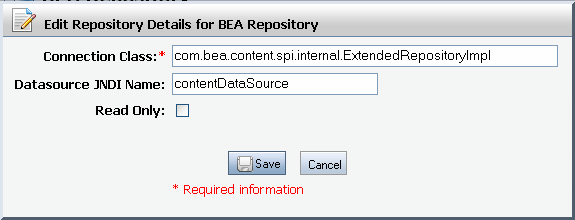

In the Repository Summary tab, click Repository Details.
In the Repository Details dialog, edit the connection class to be the following: com.bea.content.spi.internal.FileSystemRepositoryImpl
Click Save.

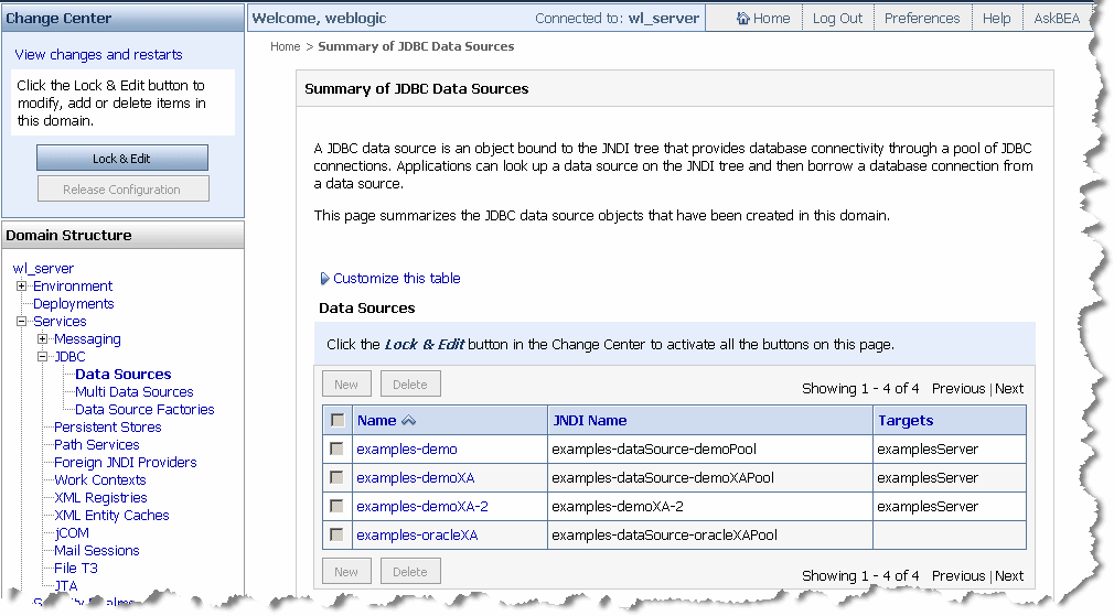

In the Domain Structure tree, open Services > JDBC > Data Sources. Figure 3-2 shows an example of the Summary of JDBC Data Sources page.
Figure 3-2 Summary of JDBC Data Sources in the WebLogic Server Console
Click Lock & Edit to ensure that the server is locked before proceeding.

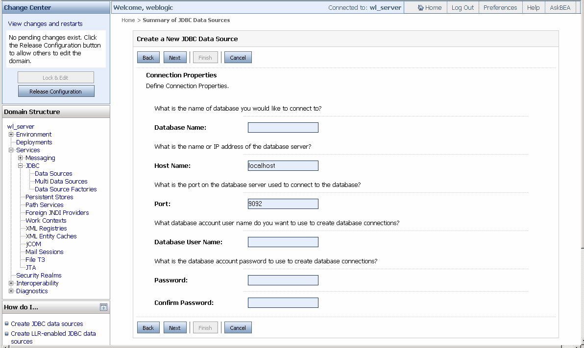

In the Data Sources table, click New. Figure 3-3 shows an example of the Create a New JDBC Data Source page.
Figure 3-3 Create a New JDBC Data Source—JDBC Data Source Properties Page
In the JDBC Data Source Properties page, complete the fields using Table 3-5.
The data source name and JNDI name need to be unique to the domain.Table 3-5 JDBC Data Source Properties
| Field Name | Input |
Name |
Enter a unique name for your new JDBC Data Source. |
JNDI Name |
Enter a unique JNDI name for your new data source. This name is used when you configure your repository. |
Database Type |
Use the drop-down list to select the database type that corresponds with your repository. |
Database Driver |
Choose a database driver. If using library services, you must use an XA driver. Note: WebLogic Portal does not support XA database drivers for Derby or MySQL databases. See Step 7. |
Click Next.
In the Transaction Options page, select any transactions options you require. If you previously selected an XA driver, there are no transaction options to select.
If you use library services, you must select an XA driver.For Derby or MySQL databases where an XA Database Driver is not supported or available, select Supports Global Transactions, which uses the LoggingLastResource global-transactions-protocol in the data source definition.
Click Next. Figure 3-4 provides an example of the Connection Properties page.
Figure 3-4 Create a New JDBC Data Source—JDBC Data Source Connection Properties Page
In the Connection Properties page, use the information in Table 3-6 to complete the dialog fields.
Table 3-6 Create a New JDBC Data Source—Connection Properties
| Connection Property | Description |
Database Name |
The name of the database you are using. |
Host Name |
Enter the host name used for the database you are using. |
Port |
Enter the port number of the port hosting your database. |
Database User Name |
Enter the database user name for the database login required for this database. |
Password |
Enter the database password. |
Confirm Password |
Enter the database password again to confirm. |
Click Next.

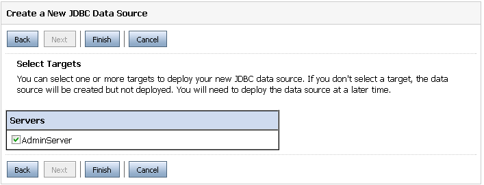

In the Select Targets page, select one or more targets to deploy your new data source, typically, AdminServer.
Figure 3-5 Create a New JDBC Data Source—Select Targets
Click Finish.
When finished adding your data source, click Activate Changes. The server is updated.
After you have configured the new repository, you need to connect it to the Virtual Content Repository.
Use the WebLogic Portal Administration Console to connect to a new repository.
From the main menu of the WebLogic Portal Administration Console, select Content > Content Management.
Select Manage | Repositories.
In the resources tree, select the Virtual Content Repository. Figure 3-6 provides an example of the Browse tab within the Repositories section.
Figure 3-6 Browse Tab within the Virtual Content Repository
On the Browse tab, click Add Repository Connection.
In the Add Repository Connection dialog, provide the following information:
Table 3-7 Repository Connection Information
| Field | Description |
Name |
The name you give your new repository. For example: |
Connection Class |
com.bea.content.spi.internal.ExtendedRepositoryImpl |
Datasource JNDI Name |
Use the Datasource JNDI name you created when you connected this repository to your server. The default value of contentDataSource is used for the WLP repository. JNDI names must be unique to the portal domain. |
Username |
The user name field is only used when connecting to a third-party repository. When configuring a WLP repository, you can leave this blank. |
Password |
Used only when connecting to a third-party repository. When configuring a WLP repository, you can leave this blank. |
Retype Password |
Enable Library Services |
Deselect this check box if you do not want to use library services with this repository. |
Click Save.
Within the Repositories section, click the repository you just created to verify that it has been created and view its Repository Summary.
