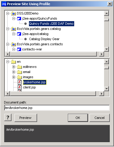

The Preview Site Using Profile dialog box appears. Use it to specify the page that you want to preview. For example, you could select the
brokerhome.jsppage from the Quincy Funds demo:
When you click OK, the system displays the specified page in your Web browser. The content of the page is personalized for the profile you selected in step 2.
