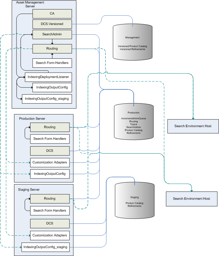

Architecture Diagram
This section provides a visual explanation of the pieces involved in an installation. For each server, the diagram shows key modules and other components.
The diagram includes the following databases, each of which includes data for several repositories:
Management—Versioned data for ATG Content Administration and other non-catalog information.
Production—Catalog and other deployed asset information for your sites. Use the switching database feature described in the ATG Content Administration Programming Guide. If you use switching, the production database becomes in actuality three databases, two containing switched data and a third containing information that does not benefit from switching, such as user profiles and ATG Search.
Staging—Duplicates the part of your production database that is necessary for staging and testing. In this configuration, that includes at least your product catalog and refinements.
If you use Oracle ATG Web Commerce Business Intelligence, you also have a data warehouse, not included in this diagram. See the ATG Business Intelligence Installation and Configuration Guide for reporting information.
Servers, Products, and Databases for Search and Commerce
