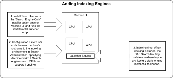

The following diagram summarizes the procedures involved. This diagram uses indexing engines as an example; to add engines dedicated to server query answers instead, you would create a new environment in Search Administration (see Step 2 in the diagram).

  8. On the machine where you have installed the standalone engine, navigate to the search engine installation and execute the <SearchEngineDir>/SearchAdmin/bin/startRemoteLauncher.sh or .bat script. The startRemoteLauncher script starts up a launcher service, which is then used by Routing to start search engines on that machine. Under normal use, you do not need to manually start or stop search engines.
    Note: This step is required only for standalone search engines. Engines running local to your Search Administration installation do not need this script.
    The startRemoteLauncher script includes two optional parameters –p and –o, which allow you to specify the ports used for remote method invocation (RMI). For example:
    startRemoteLauncher.bat -p 8860 -o 8861
    If you do not specify a port, the second port is chosen randomly. The default for the first port is always 8860.
  9. If you are adding engines for indexing purposes, see the Configuring Remote Indexing Engines section of this guide for additional steps.
In Search Administration, you can now create an environment that includes this machine. When Search indexes content (if an indexing environment) or serves answers (if a staging or production environment), the Routing module starts engine instances on that machine as needed. See the Managing Search Environments section of the ATG Search Administration Guide for information on creating search environments.
