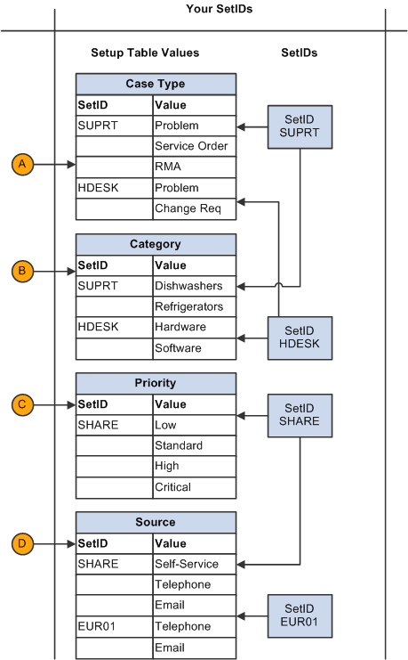

TableSet Control ExampleThe following diagram illustrates the most complex TableSet control scenario: multiple business units use some shared setup data and some unique setup data.
The diagram represents the business units and setIDs that are established by an organization with three call center business units, one for its U.S.-based help desk operations, one for its U.S. support operations, and one for its European support operations.
The organization has these requirements for sharing setup data:
There are two sets of case problem attributes (record group RC_03): one for the two support business units and one for the help desk business unit.
There is one set of case impact attributes (record group RC_04); all three business units share the values.
There are two sets of communication channel attributes (record group RC_07): one set for the U.S.-based business units and one for the European business unit.
This diagram illustrates the tables that manage the relationship between business units, record groups, and setIDs:
Business units, SetIDs, and TableSet controls
Notice the following details in the diagram:
Values that are valid for more than one setID are entered for each setID for which they are valid.
For example, both the help desk business unit and the support business units have a case type of Problem. The different business units cannot share this value because they are associated with different setIDs. Therefore, the problem case type is set up twice in the Case Type table: once under the HDESK setID, and once under the SUPRT setID.
Setting up case types is simple, involving only a setID, a unique identifier, and descriptive information. But for more complex setup tables (for example, the product table), duplicate data becomes difficult to maintain. The more complex the setup tables are, the more you have to gain by sharing values across business units.
The Case Type table is part of the record group for case problem attributes (RC_03). Therefore, the values for all tables that are in the RC_03 record group are split into help desk values (associated with the HDESK setID) and support values (associated with the SUPRT setID).
The preceding diagram illustrates two different ways of handling setIDs when values are shared by some, but not all, business units:
You can have setIDs that correspond to the specific groups of values, as the setup for the record group for case problem attributes (RC_03) illustrates: there is one setID for the support business unit and another setID for the help desk business unit.
You can use a general-purpose setID, such as SHARE, for shared values and use other setIDs on an exception basis, as the setup for the communication channels record group (RC_07) illustrates.
The system uses the default SETID table to determine default values for the setIDs that are associated with each record group in a new business unit. For example, a setID US100 might use US100 for most setIDs but use SHARE for departments. If you define US100 as the default setID for the a new business unit, then the new business unit also uses US100 for all setIDs except departments, for which it uses SHARE.

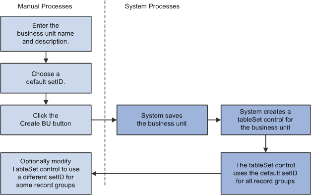

TableSet Control Setup
When you create a new business unit, the system creates a setID with the same name as the business unit. The newly created TableSet control associates all record groups with that setID. This is a convenient shortcut when you have multiple business units with identical or similar TableSet controls.
This diagram illustrates the TableSet control setup process.
To define a business unit's TableSet control:
Create the business unit on the appropriate application-specific page.
The system creates a default setID corresponding to the business unit name.
If the business unit uses only its default setID, you are finished; continue to the next step only if the business unit uses setIDs that are other than its defaults.
Use the Record Group page (in the TableSet Control component) to map setIDs to record groups.
If necessary, use the Record Group page (in the Record Group component) to review which records are in each record group.
