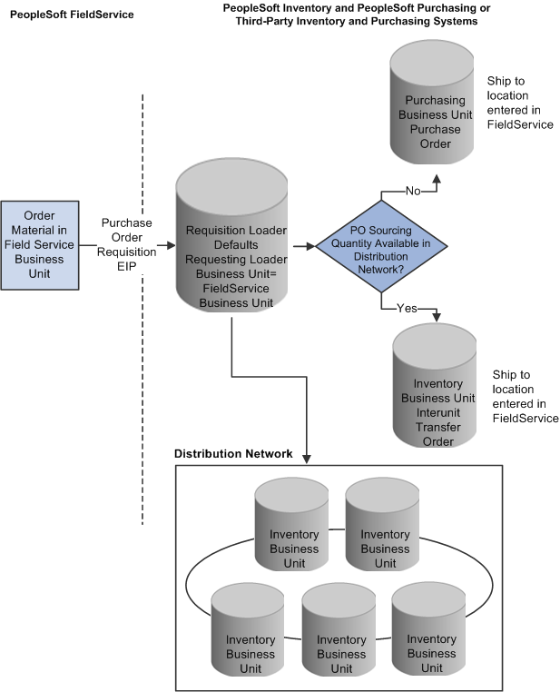

The field service business unit ID also serves as a reference key when integrating with PeopleSoft Purchasing and PeopleSoft Inventory. If you're integrating with PeopleSoft Purchasing to create requisitions for truck stock, you must define each field service business unit as a valid source of requisitions in PeopleSoft Supply Chain Management (PeopleSoft SCM). By using the Requisition Loader Defaults component in PeopleSoft SCM, you define each field service business unit as a loader business unit and establish processing defaults for requisitions that are staged by the field service business unit, including the purchasing business unit in PeopleSoft Purchasing that processes the requisitions.
When defining procurement options in PeopleSoft SCM, you can associate the field service business unit with an appropriate distribution network on the Ship To Locations page. Sourcing processes in PeopleSoft Purchasing can be configured to check available quantity first in the distribution network before creating a purchase order with an external vendor. If quantity exists in one of the inventory business units in the defined distribution network, an interunit transfer is created to fulfill the requisition.
This diagram illustrates how a field service business unit is used in both PeopleSoft CRM and the inventory and purchasing system:
Order flow from PeopleSoft Integrated FieldService to the inventory and purchasing system
