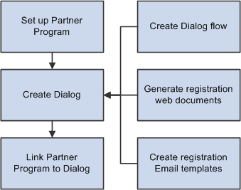

Partner Registration Setup Flow
The following diagram illustrates the registration setup flow, including partner program setup, dialog creation, and linking the partner program to the dialog:
The setup includes setting up partner programs , defining customized profile attributes in Marketing Profile (optional), creating a dialog using the PeopleSoft Online Marketing dialog functionality, associating the dialog to the partner program, and creating a dialog flow, registration Web Documents and Email notification templates. You will need to follow through this flow and complete each task to create your self-service registration process.
