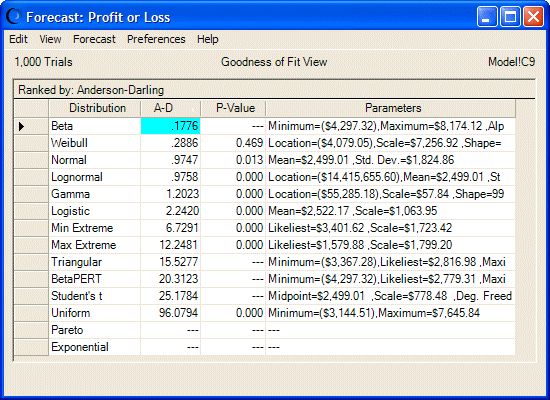

Goodness Of Fit
If you have selected distribution fitting, described in the next section, you can choose the Goodness Of Fit view to display comparative fit statistics for each of the selected distribution types. The distributions are ordered according to the selected ranking method. Figure 31, Forecast—Goodness Of Fit View shows statistics for the Anderson-Darling ranking method and each continuous distribution type. Notice that Beta is ranked highest for this forecast.
Figure 31. Forecast—Goodness Of Fit View
This figure displays the goodness of fit view. for selected distribution types.
