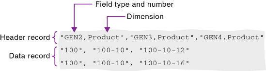

You can build dimensions dynamically by adding header information to the top record of the data source and by specifying the location of the header record in the rules file.
The header record lists field definitions for each field. The field definition includes the field type, the field number, and the dimension name into which to load the fields. Figure 65, Header Record with Three Field Definitions illustrates the format of a header record:
If the file delimiter is a comma, enclose each field definition in quotation marks (" ").

Valid field types, which must be in capital letters:
Each field type that you set requires a field number. When the field type is the name of an attribute dimension, the field number cannot be greater than 9. See Setting Field Type Information.
