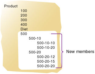

In a bottom-up data source, each record defines a single member of a dimension. The definition begins with the most specific information about the member and provides progressively more general information. A typical record specifies the name of the new member, then the name of its parent, then its parent’s parent, and so forth.
Levels are defined from a bottom-up hierarchical structure. For example, in the outline in Figure 69, Generation and Level Numbers, the lowest-level members are at the bottoms of the branches of the Product dimension.
To build the outline in Figure 69, Generation and Level Numbers, you can use the following bottom-up data source:
100-10-12 100-10 100 100-20-12 100-20 100

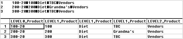

In a level reference build, the lowest-level members are sequenced left to right. Level 0 members are in the first field, level 1 members are in the second field, and so on. This organization is the opposite of how data is presented for generation references (top-down).
In the following example, the rules file uses the level reference build method to add members to the Product dimension. The rules file specifies the level number and the field type for each field of the data source (see Setting Field Type Information). The first column of the data source contains new members (600-10-11, 600-20-10, and 600-20-18). The second column contains the parents of the new members (600-10 and 600-20), and the third column contains parents of the parents (600).
For example, to build the tree in Figure 71, Levels, use Figure 70, Rules File for Level Build to set up the data source (LEVEL.TXT) and the rules file (LEVEL.RUL).

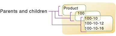

Use the parent-child references build method when every record of the data source specifies the name of a new member and the name of the parent to which you want to add the new member.
Members in a database exist in a parent-child relationship. Figure 72, Parents and Children shows part of the Product dimension with its parent and children relationships identified. Product is the parent of 100. 100 is the child of Product and the parent of 100-10, 100-10-12, and 100-10-16. 100-10, 100-10-12, and 100-10-16 are the children of 100.
A parent-child data source must contain at least two columns: a parent column and a child column, in that order. The data source can include columns with other information (for example, the alias, the attributes, or the properties of the new member). A record within a parent-child data source cannot specify multiple parents or multiple children, and cannot reverse the order of the parent and child columns.
In a parent-child build, the rules file specifies which column is the parent and which column is the child. For example, the top half of Figure 73, Rules Files for Parent-Child Build shows a data source (PARCHIL.TXT), in which each record specifies the name of a parent and the name of its child, in that order. The bottom half of the figure shows the rules file (PARCHIL.RUL) that specifies which column is the parent and which column is the child. Additionally, this example associates aliases with the child field.
Figure 74, Parents and Children shows the tree that Essbase builds from this data source and rules file.

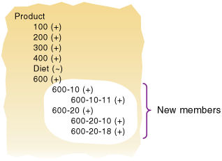

If a data source consists of a list of new members and does not specify their ancestors, Essbase must decide where in the outline to add them. Essbase provides the following build methods for this type of data source:
After Essbase adds all new members to the outline, it may be necessary to move the new members into their correct positions using Outline Editor. See Positioning Dimensions and Members.
You can add new members from a data source to an existing dimension by matching strings with existing members. When Essbase encounters a new member in a data source, it scans the outline for a member name with similar text and adds the new member as a sibling of the member with the closest string match.
For example, the data source in Figure 75, Rules File Fields Set to Add Members as Siblings with String Matches (SIBSTR.TXT) contains two new members (100-11 and 200-22) to add to the Product dimension. The new members are similar to strings in the Product dimension: they contain three digits, one dash, and two digits.
To add the example members to the database, set the values in Table 44 in the rules file:
Table 44. Example of Adding Members Using String Matches
Figure 76, Tree for Adding Members as Siblings with String Matches shows the tree that Essbase builds from this data source and rules file. 100-11 is added as a sibling of 100 and 200-22 is added as a sibling of 200.

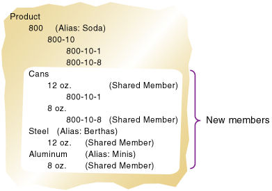

You can add all new members as children of a specified parent, generally a “dummy” parent. After Essbase adds all new members to the outline, review the added members and move or delete them in Outline Editor.
When Essbase encounters a new member in the data source, it adds the new member as a child of the parent that you define. The parent must be part of the outline before you start the dimension build.
For example, the data source in Figure 79, Rules File Fields Set to Add Members as a Child of a Specified Parent (SIBPAR.TXT) contains two new members (600-54 and 780-22) for the Product dimension (field 1). Assume that you previously added a member called NewProducts under the Products dimension.
To add the example members to the database under the NewProducts member, set the values shown in Table 46 in the rules file:
Table 46. Example of Adding Members as a Child of a Specified Parent
Enter NewProducts in the Add as Child of text box. |
Figure 80, Tree for Adding Members as a Child of a Specified Parent shows the tree that Essbase builds from this data source and rules file. 600-54 and 780-22 are added as siblings of NewProducts.

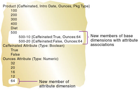

When a data source contains attribute information, you must use one or more rules files to build attribute dimensions and to associate attributes with members of their base dimensions.
You can use rules files to build attribute dimensions dynamically, to add and delete members, and to establish or change attribute associations.
Working with attributes involves the following operations:
You can use any of the following approaches to perform these operations:
Build the base and attribute dimensions and perform the associations all simultaneously. Doing so, you use a single rules file to build the base dimension and one or more attribute dimensions to associate each attribute with the appropriate member of the base dimension. Because this approach uses a single rules file, it can be the most convenient. Use this approach if the base dimension does not exist and each source data record contains all attribute information for each member of the base dimension.
Build the attribute dimension and perform the associations in one rules file. Assuming that the base dimension is built in a separate step or that the base dimension already exists, you can build an attribute dimension and associate the attributes with the members of the base dimension in one step. You need only to define the attribute associations in the rules file. See Associating Attributes.
Build the attribute dimension and then perform the associations using separate rules files. Assuming that the base dimension is built in a separate step or that the base dimension already exists, you can build an attribute dimension and associate the attributes with the members of the base dimension in separate steps. Build the attribute dimension, and then associate the attribute members with members of the base dimension. Use this approach when you build numeric attribute dimensions that are multilevel or that have members that represent different-sized ranges.

Every record of the source data must include at least two columns: one for the member of the base dimension and one for the attribute value of the base dimension member. In the same source data record you can include additional columns for other attributes that you want to associate with the member of the base dimension. You must position the field for the member of the base dimension before any of the fields for the members of the attribute dimension.
Define the field type for the attribute dimension member as the name of the attribute dimension, use the generation or level number of the associated member of the base dimension, and specify the base dimension name. For example, as shown in the ATTRPROD.RUL file in Figure 81, Rules File for Associating Attributes, the field definition Ounces3,Product specifies that the field contains members of the Ounces attribute dimension. Each member of this field is associated with the data field that is defined as the generation 3 member of the base dimension Product. Based on this field definition, Essbase associates the attribute 64 with the 500-10 member.
You can have Essbase use the attribute columns to build the members of the attribute dimensions. In Data Prep Editor, in the Dimension Build Settings tab of the Dimension Build Settings dialog box, clear the Do not create members option for the base dimension. See “Setting Member Properties” in the Oracle Essbase Administration Services Online Help.

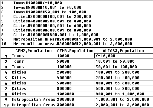

When you are working with numeric ranges, you may need to build attribute dimensions and perform associations in separate steps. See Working with Numeric Ranges.
The Caffeinated3,Product field in Figure 81, Rules File for Associating Attributes shows how to associate attributes from additional single-level attribute dimensions. Because the base dimension is already specified, you need only to define an additional field for each attribute that you want to associate with the member of the base dimension.
The file in Figure 81, Rules File for Associating Attributes associates attributes as shown in the outline in Figure 82, Associating Attributes. Member 64 is a new member of the Ounces attribute dimension. Members 500, 500-10, and 500-20 are new members of the base dimension, Product, and are associated with member 64.
You can also use the rules file shown in Figure 81, Rules File for Associating Attributes to change attribute associations. Ensure that you allow association changes. In Data Prep Editor, on the Dimension Build Settings tab of the Dimension Build Settings dialog box, check Allow association changes for the base dimension. See “Setting Member Properties” in the Oracle Essbase Administration Services Online Help.

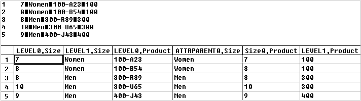

The position of the fields in the rules file is important.
Place the copied attribute dimension field or fields that define the association immediately to the right of the field for the members of the base dimension.
For a multilevel attribute dimension, place the attribute parent field immediately to the left of the field that is the child of the attribute parent.

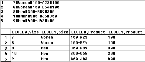

The following steps describe how to define the fields in the rules file to build a multilevel attribute dimension and associate its members with members of its base dimension. This example uses the level references build method.
In the rules file, in field 1 and field 2, define the attribute dimension fields in the same way in which you define standard dimensions; specify type (level or generation), number, and dimension name.
Essbase uses field1 and field2 to build the attribute dimension.
Define the fields for building the base dimension.
In the following example, you are defining the level 0 and level 1 fields for the Product dimension. Figure 83, Defining Multilevel Attribute Dimensions Before Adding the Association Fields shows the fields of the rules file at this stage.
To define the association, make a copy of the field that contains the level 0 attribute.
In the current example, make a copy of field 1.
Use the attribute dimension name as the field type and specify the generation or level number of the member of the base dimension with which Essbase associates the attribute; for example, Size0.
Move the new field immediately to the right of the field for the base dimension with which Essbase associates the attribute.
In the current example, move the new field to the right of the field Level0, Product.
Make a copy of the field containing the parent of the attribute field.
In the current example, make a copy of field 2.
Set the field type of the new field as Attribute Parent and specify the generation or level number of the base member with which you want Essbase to associate the attribute; for example, ATTRPARENT0.
Move the ATTRPARENT field immediately to the left of the attribute association field that you created in step 3.

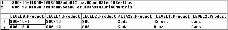

As shown in Figure 84, Source Data and Rules File for Building a Multilevel Attribute Dimension, the rules file now contains the field definitions to build the attribute dimension Size and to associate the members of Size with the appropriate members of the base dimension Product.
When you run a dimension build with the data shown in Figure 84, Source Data and Rules File for Building a Multilevel Attribute Dimension, Essbase builds the Size attribute dimension and associates its members with the appropriate members of the base dimension. Figure 85, Multilevel Attribute Dimension shows the updated outline.
In many cases, you can use one rules file in a dimension build operation to dynamically build attribute dimensions for numeric ranges and to associate the members of the base dimension with the ranges. In the following situations, however, you must use two rules files: one to build the attribute dimension and one to associate the attributes with the appropriate members of the base dimension:

First, create a rules file that uses the generation, level, or parent-child build method to build the attribute dimension. In the rules file, specify the following information:
The source data must be in attribute sequence, in ascending order. If ranges have different sizes, the source data must include a record for every attribute range.
To use the generation method to build the outline in Figure 86, Numeric Attribute Dimension with Different-Sized Ranges, you must sequence the source data in ascending sequence, based on the numeric attribute value. Define the fields in a rules file as shown in Figure 87, Rules File for Building a Numeric Attribute Dimension with Ranges. Additionally, Figure 87, Rules File for Building a Numeric Attribute Dimension with Ranges shows how to associate aliases with attributes.

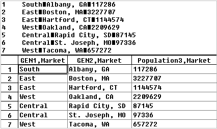

Define the rules file as shown in Figure 88, Rules File for Associating Numeric Range Attributes.
When you define the association field (for example, Population3, Market), place the attribute members within a range. In Data Prep Editor, on the Dimension Build Properties tab of the Field Properties dialog box, select “Place attribute members within a numeric range.”
Figure 88, Rules File for Associating Numeric Range Attributes includes a city, Boston, whose population of 3,227,707 is outside the ranges of the attribute dimension in Figure 86, Numeric Attribute Dimension with Different-Sized Ranges, where the ranges extend only to 3,000,000. To allow for values in the source data that are outside the ranges in the attribute dimension, enter a range size, such as 1000000. Essbase uses the range size to add members to the attribute dimension above the existing highest member or below the existing lowest member, as needed. |
To ensure the validity of attribute associations, you must select the correct dimension building options and perform the builds in the proper sequence.
Adding or Changing Members of the Attribute Dimension: After you associate members of a base dimension with their numeric attribute ranges, if you manually insert new members or rename existing members in the attribute dimension, ensure that associations between attributes and base members are correct by performing one of the following tasks:
Deleting Members from the Attribute Dimension: You can delete all members of an attribute dimension so that you can rebuild the dimension with new data. In Data Prep Editor, on the Dimension Building Properties tab on the Field Properties dialog box, click the Ranges button and select Delete all members of this attribute dimension. Essbase uses the start value and range size value to rebuild the attribute dimension. To ensure proper attribute association, on the Dimension Build Settings tab of the Dimension Build Settings dialog box, you must select the Allow association changes option for the base dimension.
Adding Members to the Base Dimension: You can use the same rules file to add new members to the base dimension and to associate the new members with their numeric range attributes simultaneously. Provide a value for the range size. In Data Prep Editor, on the Dimension Build Properties tab in the Field Properties dialog box, click the Ranges button and specify the range size for the attribute dimension.

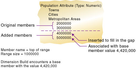

If Essbase encounters a base dimension value that is greater than the highest attribute member by more than the range size or is lower than the lowest attribute member by more than the range size, it creates members in the attribute dimension to accommodate the out-of-range values.
For example, in Figure 89, Dynamically Adding Attribute Range Members, the numeric range attributes are defined as “Tops of ranges.” The highest value member of the Population attribute dimension is 3000000. If the source data includes a record with the population 4,420,000, and the range size is 1000000, Essbase adds two members to the attribute dimension, 4000000 and 5000000, and associates the base member with the value of 4,420,000 with the 5000000 attribute.
When you add range members and base dimension members simultaneously, Essbase does not create aliases for the new members of the attribute dimension. If you want aliases that describe the range values for the new members of the attribute dimension, you must add the aliases in a separate operation.

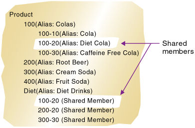

The data associated with a shared member comes from an actual member with the same name as the shared member. Because the shared member stores a pointer to data contained in the actual member, the data is shared between the members and is stored only once.
For example, member 100-20 (Diet Cola) rolls up into the 100 family and into the Diet family.
You can share members among as many parents as you want. Diet Cola has two parents (100 and Diet), but you can define it to roll up into more parents.
You can share members at multiple generations in the outline. In Figure 90, Shared Members in the Sample.Basic Database, Diet Cola is shared by two members at generation 2 in the outline, but it can be shared by a member at generation 3 and a member at generation 4, as shown in Figure 95, Sample Outline: Members Shared at Different Generations.
Creating shared members at different generations in the outline is easy in Outline Editor; creating shared members using dimension build is more difficult. You must pick the build method and format the data source carefully.
The following sections describe how to build shared members in the outline by using a data source and a rules file.
Members that are shared at the same generation roll up into the same branch. 100-20 (Diet Cola) is shared by two parents (100 and Diet). Both parents roll up into the same branch (the Product dimension), and both parents are at generation 2, as shown in Figure 91, Sample Outline: Members Shared at the Same Generation:
Sharing members at the same generation is the simplest way to share members, and can be accomplished using generation, level, or parent-child references. See:

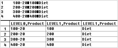

To create shared members of the same generation by using the level references build method, first ensure that the primary and any secondary roll-ups are specified in one record. You can specify as many secondary roll-ups as you want, as long as they are all in one record.
Define the field type for the shared member as LEVEL. Then enter the level number. To create a shared member of the same generation, set the level number of the secondary roll-up to have the same number of levels as the primary roll-up. While processing the data source, Essbase creates a parent at the specified level and inserts the shared members under it.
For example, to create the shared members 100-20 (Diet Cola), 200-20 (Diet Root Beer), 300-20 (Diet Cream Soda), and 400-20 (Diet Fruit Soda), use the sample data source file (SHLEV.TXT) and set up the rules file so that the fields look like the sample rules file (SHLEV.RUL) shown in Figure 93, Sample Rules File: Members Shared at the Same Generation Using Level References.

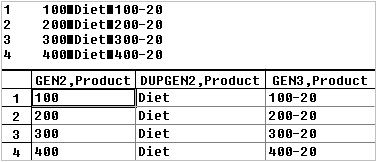

To create shared members of different generations by using the level references build method, ensure that primary and secondary roll-ups are specified in one record. You can specify as many secondary roll-ups as you want, as long as they are all in one record.
Define the field type for the shared member as LEVEL. Then enter the level number. While processing the data source, Essbase creates a parent at the specified level and inserts the shared members under it.
For example, to share the products 100-20, 200-20, and 300-20 with a parent called Diet and two parents called TBC and Grandma’s, use the sample data file and the rules file shown in Figure 96, Sample Rules File: Members Shared at Different Generations Using Level References:

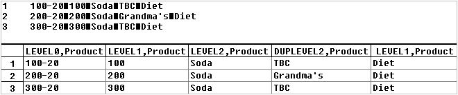

To create shared non-level 0 members by using the level references build method, ensure that primary and secondary roll-ups are specified in one record. You can specify unlimited secondary roll-ups, as long as they are all in one record.
Define the field type for the parent of the shared member as duplicate level (DUPLEVEL), and then enter the level number. To create a shared member of the same generation, set the level number of the secondary roll-up to have the same number of levels as the primary roll-up. While processing the data source, Essbase creates a parent at the specified level and inserts the shared members under it.
For example, to share the product lines 100, 200, and 300 with a parent called Soda and parents called TBC and Grandma’s, use the sample data file and rules file shown in Figure 99, Sample Rules File: Non-Level 0 Members Shared at Different Generations Using Level References. This data source and rules file work only if the Diet, TBC, and Grandma’s members exist in the outline. The DUPLEVEL field is always created as a child of the dimension (at generation 2), unless the named level field already exists in the outline.

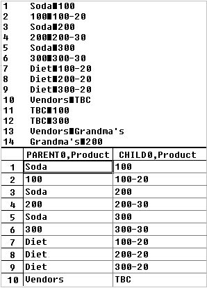

The parent-child references build method is the most versatile for creating shared members. It does not have any restrictions on the position of the shared members in the outline, unlike the generation references and level references build methods.
To create non-level 0 shared members at the same generation using the parent-child references build method, define the PARENT and CHILD field types. Ensure that Essbase is set up to allow sharing (clear Do Not Share in the Dimension Build Settings tab of the Dimension Build Settings dialog box). When sharing is enabled, Essbase automatically creates duplicate members under a new parent as shared members.
To enable the retrieval of totals from multiple perspectives, you can also put shared members at different levels in the outline by using the level references build method. For example, the rules file (LEVELMUL.RUL) shown in Figure 101, Sample Rules File: Multiple Roll-Ups at Different Levels Using Level References and Figure 102, (Continuation) Sample Rules File: Multiple Roll-Ups at Different Levels Using Level References specifies build instructions for levels in the Product dimension:
Because the record is so long, this second graphic shows the rules file scrolled to the right to show the extra members:
Figure 102. (Continuation) Sample Rules File: Multiple Roll-Ups at Different Levels Using Level References
When you run the dimension build using the data in Figure 102, (Continuation) Sample Rules File: Multiple Roll-Ups at Different Levels Using Level References, Essbase builds the outline shown in Figure 103, Sample Outline: Multiple Roll-Ups at Different Levels:
This example enables analysis not only by package type (Cans), but also by packaging material (comparing sales of aluminum cans and steel cans).
Because Product is a sparse dimension, you can use an alternative outline design to enable retrieval of the same information. For example, consider creating a multilevel attribute dimension for package type with Steel and Aluminum as level 0 members under Can. For outline design guidelines, see Analyzing Database Design.

Parent-child dimension builds: The parent-child build method requires two fields, one for parent and one for child. For duplicate member situations the parent field must contain the qualified member name. Parent-child dimension builds on duplicate member outlines do not support attribute association. To ensure that attributes are associated with the correct members, perform the associations in a separate pass, using a generation-reference or level-reference rules file.
