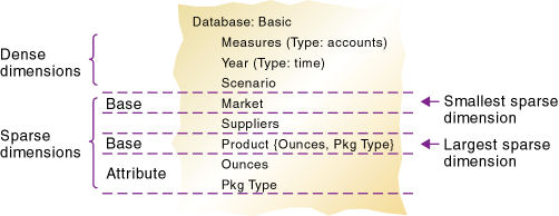

Position attribute dimensions at the end of the outline. Position dense dimensions before sparse dimensions.
The position of dimensions in an outline and the storage properties of dimensions can affect two areas of performance—how quickly calculations are run and how long it takes users to retrieve information.
Use the following topics to understand performance optimization basics.
To optimize query performance, use the following guidelines when you design an outline:
The outline in Figure 31, Designing an Outline for Optimized Query Times is designed for optimum query performance:
Because the outline contains attribute dimensions, the storage property for standard dimensions and all standard dimensions members is set as store data.
As the most-queried sparse dimension, the Product dimension is the first of the sparse dimensions. Base dimensions are typically queried more than other dimensions.
To optimize calculation performance, order the sparse dimensions in the outline by their number of members, starting with the dimension that contains the fewest.

The outline in Figure 32, Designing an Outline for Optimized Calculation Times is designed for optimum calculation performance:
The smallest standard dimension that is sparse, Market, is the first of the sparse dimensions in the outline.
The largest standard dimension that is sparse, Product, is immediately above the first attribute dimension. If the outline did not contain attribute dimensions, the Product dimension would be at the end of the outline.
Although they contain the same dimensions, the example outlines in Figure 31, Designing an Outline for Optimized Query Times and Figure 32, Designing an Outline for Optimized Calculation Times are different. To determine the best outline sequence for a situation, prioritize the data retrieval requirements of the users against the time needed to run calculations on the database. How often do you expect to update and recalculate the database? What is the nature of user queries? What is the expected volume of user queries?
A possible workaround is initially to position the dimensions in the outline to optimize calculation. After you run the calculations, you can manually resequence the dimensions to optimize retrieval. When you save the outline after you reposition its dimensions, choose to restructure the database by index only. Before you run calculations again, resequence the dimensions in the outline to optimize calculation.
