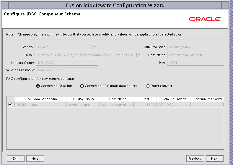

In the Configure JDBC Component Schema screen (Figure 10-2), do the following:
Select UCM Schema (for WebCenter Content). Do not select any of the other existing schemas.
Figure 10-2 Configure JDBC Component Schema Screen for Oracle WebCenter Content
For the RAC configuration, you can select Convert to GridLink or Convert to RAC multi data source (described in Appendix A, "Using Multi Data Sources with Oracle RAC"). For the instructions given here, select Convert to GridLink.
After you select a RAC configuration, all selected schemas are grayed.
Click Next.

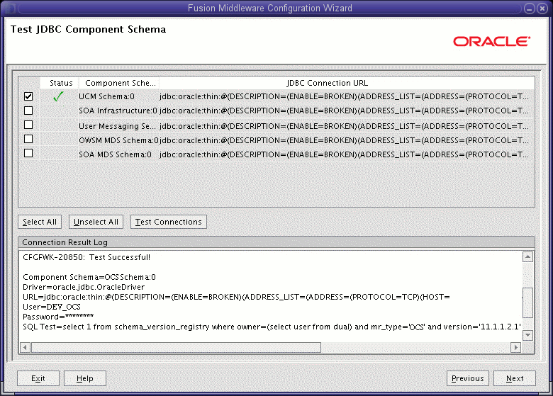

In the Test JDBC Component Schema screen (Figure 10-4), select the UCM Schema row, then click Test Connections.
The Connection Results Log displays the results. Ensure that the connection to the database that contains the schema was successful. If not, click Previous to return to the previous screen, correct your entry, and then retry the test.
Figure 10-4 Test JDBC Component Schema Screen for WebCenter Content
Click Next when the connection is successful.
