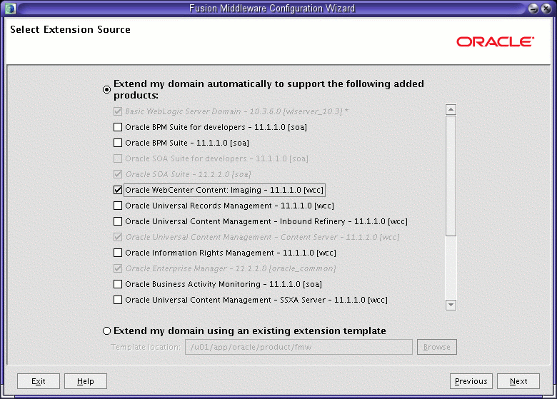

  4. In the Welcome screen, select Extend an existing WebLogic domain, and click Next.
  5. In the WebLogic Domain Directory screen, select the WebLogic Server domain directory (ORACLE_BASE/admin/domain_name/aserver/domain_name), and click Next.
  6. In the Select Extension Source screen (Figure 11-1), make these selections:
    • Select Extend my domain automatically to support the following added products.
    • Select this product:
      Oracle WebCenter Content: Imaging - 11.1.1.0 [wcc]
      The following products should already be selected and grayed out. They were selected when you created the domain (Section 8.3) or extended it for Oracle SOA Suite components (Section 9.3) or WebCenter Content (Section 10.3).
      Basic WebLogic Server Domain - 10.3.6.0 [wlserver_10.3]
      Oracle SOA Suite for developers - 11.1.1.0 [soa]
      Oracle SOA Suite - 11.1.1.0 [soa]
      Oracle Universal Content Management - Content Server - 11.1.1.0 [wcc]
      Oracle Enterprise Manager - 11.1.1.0 [oracle_common]
      Oracle WSM Policy Manager - 11.1.1.0 [oracle_common]
      Oracle JRF - 11.1.1.0 [oracle_common]
    Figure 11-1 Select Extension Source Screen for Imaging
    Description of Figure 11-1 follows
    Description of "Figure 11-1 Select Extension Source Screen for Imaging"
    Click Next.

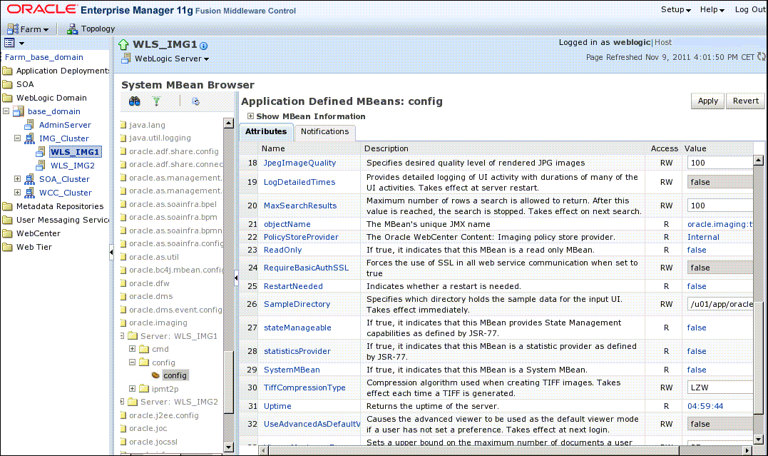

11.13 Configuring System MBeans for Oracle WebCenter Content: Imaging
To configure the following system MBeans for Oracle WebCenter Content: Imaging:
  1. Log in to Oracle Fusion Middleware Control at http://ADMINVHN:7001/em (Figure 11-7).
    Figure 11-7 System MBean Browser
    Description of Figure 11-7 follows
    Description of "Figure 11-7 System MBean Browser"
  2. In the left pane, expand the farm domain name, then expand WebLogic Domain, then the domain name, then IMG_Cluster, and then click the WLS_IMG1 link.
  3. At the top of the right-hand panes, click the WebLogic Server drop-down menu and choose System MBean Browser.
  4. Expand Application Defined MBeans and then oracle.imaging.
  5. Expand Server: WLS_IMG1 and then config.
  6. Click the config bean link.
  7. In the right pane, set the InputDirectories MBean to specify the path to the input files: ORACLE_BASE/admin/domain_name/img_cluster_name/input_files.
    Please note that all Oracle WebCenter Content servers involved must be able to resolve this location (that is, via the NFS mount point).
  8. Set the SampleDirectory MBean: ORACLE_BASE/admin/domain_name/img_cluster_name/input_files/Samples.
    To process input files, the input agent must have the appropriate permissions for the input directory, and the input directory must allow file locking. The input agent requires that the user account that is running the WebLogic Server service have read and write privileges for the input directory and for all files and subdirectories in the input directory. These privileges are required so that the input agent can move the files to the various directories as it works on them. File locking on the share is needed by the input agent to coordinate actions between servers in the cluster.
  9. Set the GDFontPath MBean to specify the path to the GD fonts for the X Windows environment. Check with your system administrator. The default is likely /usr/share/X11/fonts/TTF or /usr/lib/X11/fonts/TTF.
  10. Click Apply.
