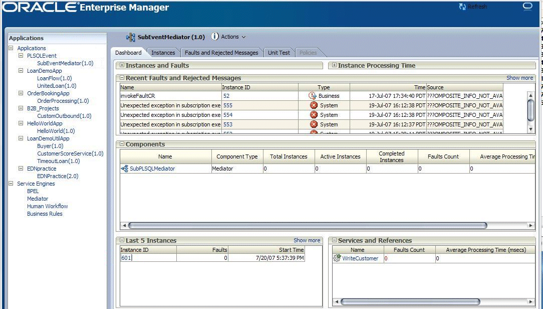

  2. From the list of applications, expand the PLSQLEvent composite.
  3. In the Last 5 Instances pane, click the most recent instance as shown in Figure 34-1.

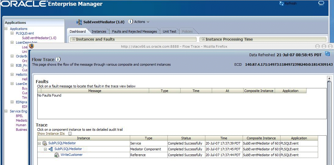

  4. In the Flow Trace window that displays, click the Oracle Mediator component, as shown in Figure 34-2.
    Figure 34-2 The Flow Trace Window
    Description of Figure 34-2 follows
    Description of "Figure 34-2 The Flow Trace Window"

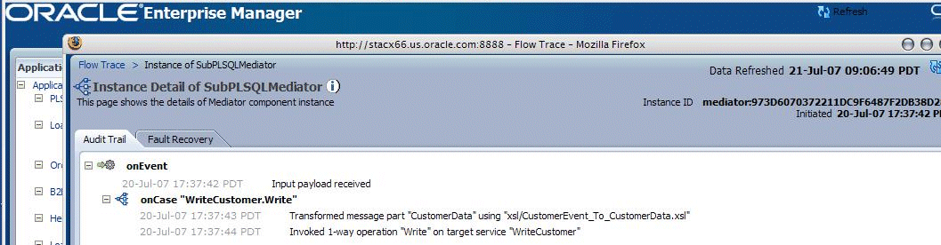

    A window displays, showing the event results, as shown in Figure 34-3.
    Figure 34-3 Displaying the Event
