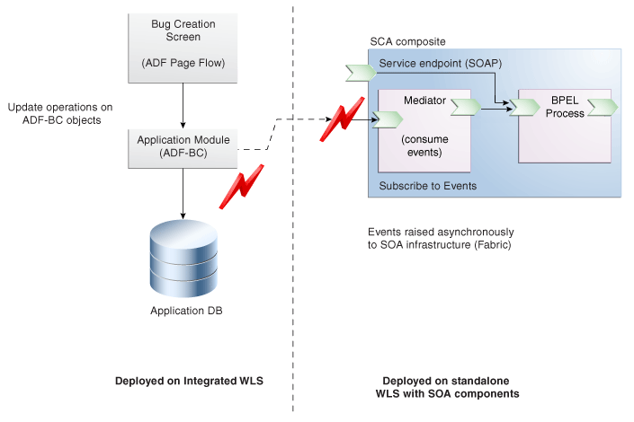

Oracle Fusion applications initiate business processes in response to user actions. Oracle ADF provides a change notification framework that is triggered at the end of a transaction involving ADF Business Components. This notification can be declaratively configured to raise business events that conform to an Event Description Language (EDL) definition. When an event is raised, it is published on the Event Delivery Network (EDN). For more information about the EDN, see the chapter "Using Business Events and the Event Delivery Network" in the Oracle Fusion Middleware Developer's Guide for Oracle SOA Suite.
Process flows are implemented using a BPEL process service component as a bridge from EDN to the BPEL process. Because the events raised by the ADF Business Components are not a native BPEL construct, you use a mediator service component to subscribe to the event and to then invoke the BPEL process service component. The mediator service component acts as a binding between the EDN and the BPEL process service component. Whenever the event is raised by ADF Business Components (whether through a GUI action or programatically), the BPEL process service component is invoked. Figure 33-1 illustrates how these work together.

A web application built using ADF Business Components and Oracle ADF Faces allows users to register bugs found in software. An ADF Business Components entity object is used to create a bug, and contains an event whose payload is the attribute values for the created bug. The event is configured to be raised whenever the Create operation is called on the entity object.
A mediator service component subscribes to the event and accepts the event payload. A routing rule is configured for the mediator service component that routes the payload for the event to a BPEL process service component. This component then sends an email that contains the information from the payload to the bug's creator.

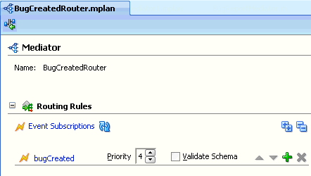

Open the MPLAN file for the mediator service component and create a new subscription that points to the EDL file moved into the source path. This means the mediator service component will now be subscribed to that event.
In the following sample application, a mediator service component named BugCreatedRouter
is subscribed to the BugCreated
event, as shown in Figure 33-2.

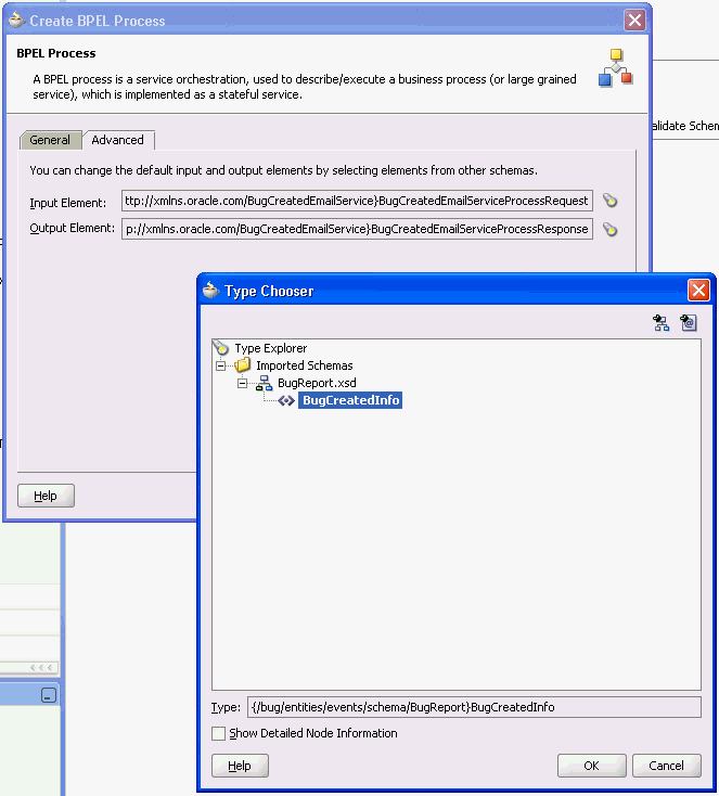

Use the Create BPEL Process dialog to configure the payload. Use the Input Element finder icon to select the payload from the schema created for the event.
In the sample application, the input element would be the BugCreatedInfo
payload under the BugReport.xsd
node, as shown in Figure 33-3.

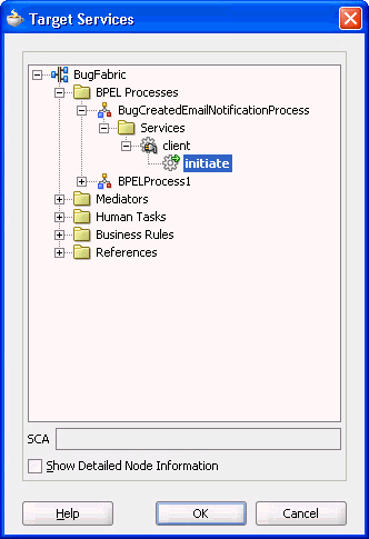

In the mediator service component, add a routing rule and configure it so that it invokes the BPEL process service and contains a subscription to the ADF Business Components event. Ensure the following:
You select the initiate
operation on the client of the BPEL process service component as the target service, as shown in Figure 33-4.
