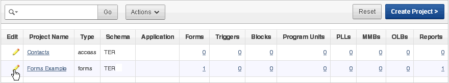

4.5 Create a Conversion Project
Next, create a conversion project by running Create Migration Project Wizard and loading the application metadata extracted in "Convert Oracle Forms to XML".
To create a conversion project:
  1. Log in the workspace you created for your conversion project as described in "Logging In To Your Oracle Application Express Workspace".
  2. Click the Application Builder icon.
  3. Click Migrations on the right side of the page.
    Description of migration_link.gif follows
  4. On the Application Migrations page, click Create Project.
    The Create Migration Project wizard appears. The steps included in the wizard appear in a flowchart on the left of the page.
  5. Enter the project details:
    1. Project Name - Enter a unique name. The project name must be unique to your current workspace and should not contain any white spaces.
    2. Type - Select Forms.
    3. Description - Enter a meaningful description for this project.

4.6.1 About the Application Migrations Page
The Project page shows a high-level overview of your Oracle Forms conversion project.
Description of project_page_forms.gif follows
Topics:
4.6.1.1 Understanding the Project Page
To view project details, click the project name. The Project page appears.

  6. Click the Delete Project button and confirm the deletion.
