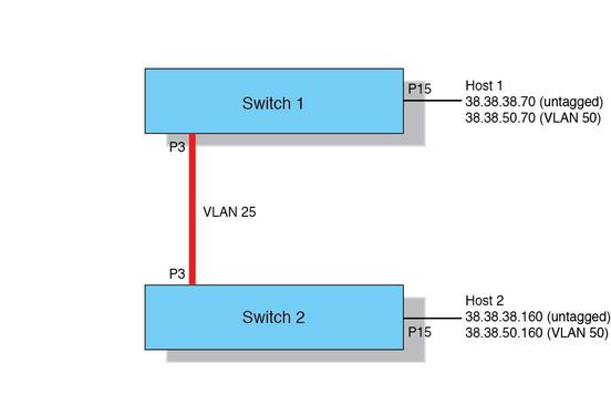

This section contains an example of how to configure QinQ in SEFOS. In this example, two end devices are connected to two QinQ-enabled SEFOS switches, as shown in the following illustration. The end nodes communicate using untagged frames, as well as frames tagged with VID=50. The SEFOS switches are interconnected with VID=25.
