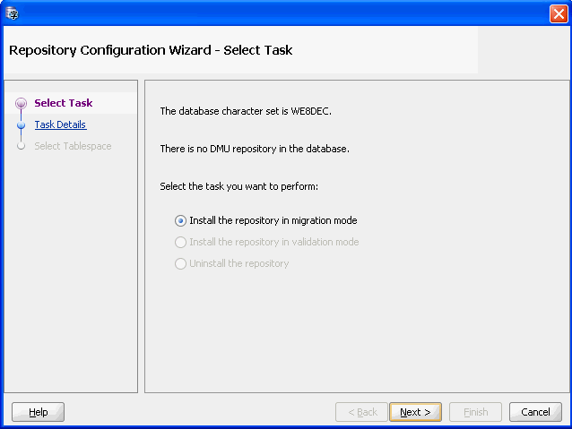

  1. If you connect to a database for the first time, the DMU automatically prompts you to install the repository. If you are not prompted to install the repository, you can install it by right-clicking the database you want to use, and selecting Configure DMU Repository. You can also select Configure DMU Repository from the Migration menu. In all of these cases, the Repository Configuration Wizard appears. Figure 2-2 shows how it appears.
    Figure 2-2 Repository Configuration Wizard - Select Task
    Description of Figure 2-2 follows
    Description of "Figure 2-2 Repository Configuration Wizard - Select Task"
  2. On the first page of the wizard, the only choice available is Install the repository in migration mode. After selecting this, click Next.
    After you click Next, the second page of the Repository Configuration Wizard is shown. Figure 2-3, "Repository Configuration Wizard - Task Details" is an example of this page.

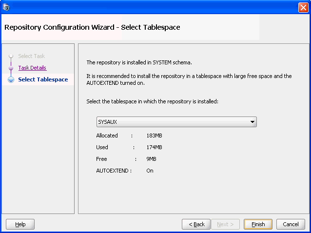

  4. On the third page, you can select the tablespace in which you want to install the repository. The default tablespace is SYSAUX. Oracle recommends that a separate, empty tablespace be used for the migration repository. This helps to avoid fragmentation of the production tablespaces. Ensure that the amount of free space available in the chosen tablespace is sufficient to hold the repository contents. Because the amount of space required by the repository heavily depends on the rowid collection level you choose for scanning and the amount of character data in the database that requires conversion or has convertibility issues, the space required by the repository is difficult to estimate. Therefore, Oracle recommends that you enable the autoextend option on the data files of the repository tablespace to allow the tablespace to grow, if necessary. Define the maximum size constraints for the data files to avoid exhausting the entire disk space.
    Note that the tablespace for installing the DMU repository must have a block size of 8K or above.
    Click Finish to install the repository.
