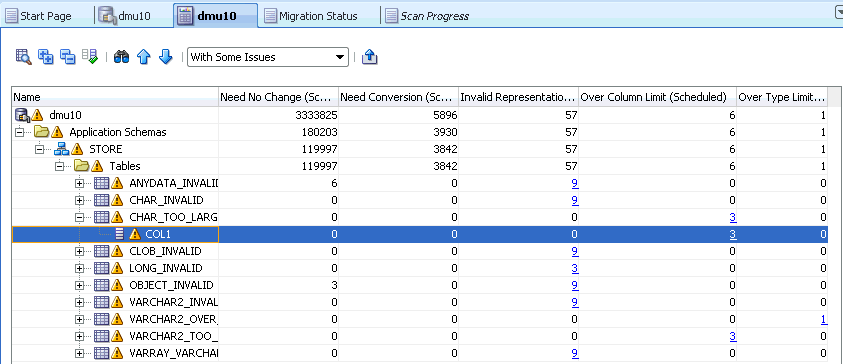

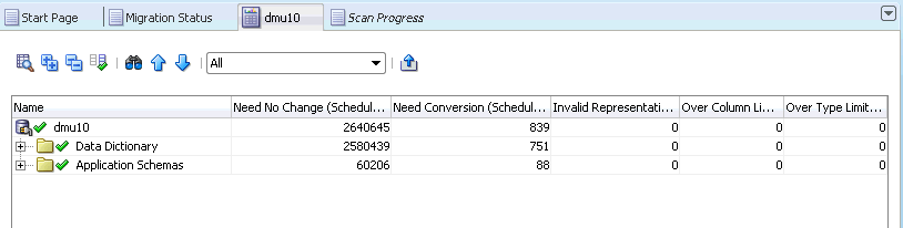

To make working with large tables easier, the Cleansing Editor tab provides a powerful filtering feature. You can filter rows included in the editor grid on the types of the convertibility issues that they contain or on an arbitrary SQL condition.
You can select the types of convertibility issues to include from the Filter drop-down list on the Cleansing Editor toolbar. The choices are:
All
This option switches off filtering on convertibility issues and causes rows with any contents to be included.
Requiring Conversion
This option shows all rows that are not changeless, that is, one or more columns contain data that needs conversion and, optionally, has length expansion or invalid representation issues.
Exceeding Column Limits
This option shows all rows in which one or more column values exceed their column limit after conversion.
Exceeding Data Type Limit
This option shows all rows in which one or more column values exceed their data type limit after conversion.
Invalid Binary Representation
This option shows all rows in which one or more columns contain invalid character codes.

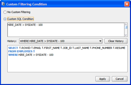

In addition to the filtering based on convertibility status of rows, you can specify an arbitrary SQL condition to be added to the query that the DMU sends to the database to retrieve data from the edited table. Specify the condition in the Custom Filtering Condition dialog box, shown in Figure 6-3, "Custom Filtering Condition". Open the dialog box by clicking on Customize Filtering Condition on the toolbar of the Cleansing Editor tab. Select the Custom SQL Condition option in the dialog box and enter the desired condition. Click Apply. The condition is applied to the table to create a subset of rows to fetch and then the filtering on convertibility issues is applied to this subset. To remove the filtering condition, reopen the Custom Filtering Condition dialog box, select the No Custom Filtering option and click Apply.

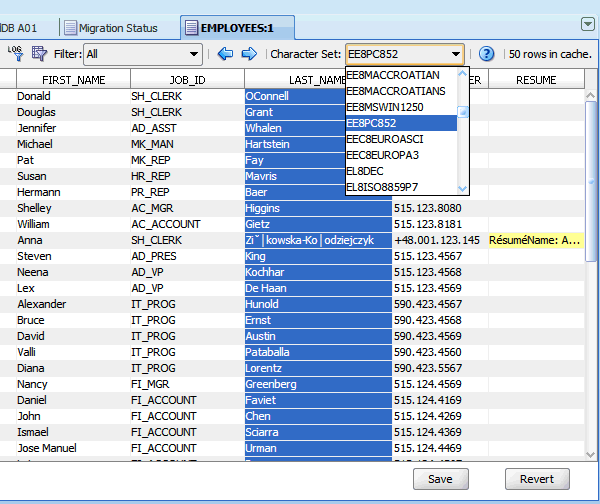

The assumed column character set is used not only for conversion to Unicode but also when column data is interpreted for display in the Cleansing Editor, Edit Data dialog box, or Show Data dialog box. The displayed data looks correctly to a human reader only if its interpretation happens according to its real character set or according to a binary superset of the real character set. Otherwise, displayed values contain unexpected characters or replacement characters. (Replacement characters are usually represented by rectangular shapes of the size of an uppercase letter. This representation is platform-dependent.) This fact lets you verify the assumed column character set has been chosen correctly, if all data in the column looks correct.
You might want to set the assumed character set of a column even if the column scan results report only convertible contents without issues. The reason being that data in a real character set that is different from the database character set might still consist of byte sequences that could be interpreted as valid in the database character set – even if this interpretation does not produce reasonable text. This is especially true for single-byte database character sets in which most byte values (0..255) have a valid character assigned in the character set definition. CL8MSWIN1251 is the prominent example, with only one byte value not assigned to any character.
You can identify the real character set of a column by doing either of the following:
Collecting the necessary information about the relevant application configuration, database clients, and client character sets (the preferred method)
Selecting successive character sets as the assumed character set of the column and verifying the correctness (legibility) of displayed text
The second method might be very useful if you know the language of the data, but not the specific character set used to encode it. For example, you know that text in a column is in Japanese but you do not know if it is encoded in EUC-JP (JA16EUC) or Shift-JIS (JA16SJIS).
To set the assumed character set of a column in the Cleansing Editor, select the column by clicking its heading and select the desired character set in the Character Set drop-down list on the toolbar, as shown in Figure 6-4, "Setting Assumed Column Character Set". The contents of the selected column will be redisplayed according to the new interpretation. Try another character set, if the data is illegible. Also, the color highlighting (see "Cleansing Data: Color Highlighting") will tell you if some bytes in the column cannot be interpreted according to the selected character set.

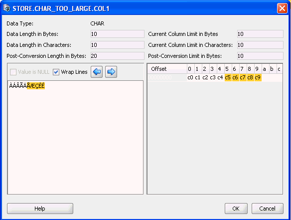

Open the Edit Data dialog box, shown in Figure 6-5, "Edit Data Dialog Box", by double-clicking a table cell in the Cleansing Editor or by selecting Edit Data from the context menu of the current cell. The value of the cell is shown in the main text area of the dialog box and can be edited by adding, changing, or deleting characters. If the value contains end-of-line characters (LF=0x0A), it will be displayed in multiple lines. The Wrap Lines check box determines how lines longer than the width of the text area are displayed. If the check box is selected, the dialog box wraps the long lines into multiple lines of the text area. If the check box is not selected, the lines are not wrapped and the dialog box shows a horizontal scroll bar to let you scroll the text area.
The Edit Data dialog box shows the following data about the text value being edited:
Data Type
This is the data type of the column to which the value belongs, such as VARCHAR2
, CHAR
, LONG
, or CLOB
Data Length in Bytes
This is the length in bytes that the edited value would have, if it were stored in the database.
Data Length in Characters
This is the length in characters that the edited value would have, if it were stored in the database.
Post-Conversion Length in Bytes
This is the length in bytes that the edited value would have, if it were stored in the database after conversion to the target Unicode character set.
Current Column Limit in Bytes
This is the maximum length in bytes that the value might currently have to fit into its column in the database.
Current Column Limit in Characters
This is the maximum length in characters that the value might currently have to fit into its column in the database. Nothing is displayed if the column uses byte-length semantics.
Post-Conversion Limit in Bytes
This is the maximum length in bytes that the value will be allowed to have to fit into its column in the database after conversion to Unicode.
When editing a value, you must always ensure that Data Length in Bytes is not greater than Current Column Limit in Bytes and that Data Length in Characters is not greater than Current Column Limit in Characters (if specified). To resolve the "exceeds column limit" issue for the value, you must also ensure that Post-Conversion Length in Bytes is not greater than Post-Conversion Limit in Bytes.
Characters that cause the current value to exceed its Post-Conversion Limit in Bytes are shown on yellow background. This lets you quickly estimate how much a value must be truncated to resolve the "exceeds column limit" issue.
In the bottom right, the edited text is displayed as a sequence of hexadecimal numbers corresponding to bytes that comprise (encode) the text when it is stored in the database.
By looking at numeric values of bytes comprising the edited text you can:
Identify binary values, such as images or encryption results, stored invalidly in a character column
Such values usually contain some bytes from ranges 0x00 to 0x08 and 0x10 to 0x1f. Because bytes in these ranges are control codes rarely used today, values containing such bytes are almost never pure text values.
Identify corrupted characters
If you see replacement characters in the edited text in the text, you can view the binary display to analyze particular bytes corresponding to these characters. By identifying the language of the data and looking at definitions of character sets valid for this language, you can diagnose the issue as an incorrect character set of data or as corrupted character codes, that is, bytes missing from multibyte codes or random bytes resulting from software bugs or hardware malfunction.
You can insert, modify, or delete bytes in the edited value to fix corruption issues. Click a byte to make it current. Right-click anywhere in the edit area to open the context menu. Select Insert to add a byte before the current one. Select Delete to remove the current byte from the value. Select Modify to change the value of the current byte. Double-clicking a byte is equivalent to selecting it as current and selecting Modify.
After making all your intended modifications in the Edit Data dialog box, click OK to accept them and to close the dialog box. Click Cancel, if you want to close the dialog box and discard the modifications. After accepting the modifications, you still have to click Save on the Cleansing Editor tab to save them in the database.

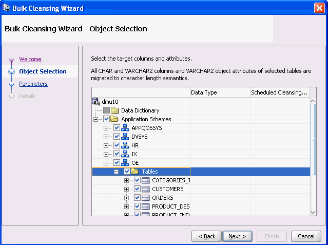

Click Next and Figure 6-9, "Bulk Cleansing Wizard - Object Selection" appears.
Figure 6-9 Bulk Cleansing Wizard - Object Selection
Select the objects to be migrated to character length semantics. The Data Type and Scheduled Cleansing Action columns show the current data types of the columns and any existing scheduled cleansing actions. Objects that are already in character length semantics or objects that are not supported for character length semantics migration are not selectable in the navigator tree. Click Next and Figure 6-10, "Bulk Cleansing Wizard - Parameters" appears.

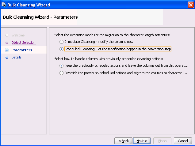

Figure 6-10 Bulk Cleansing Wizard - Parameters
Select the execution mode for bulk cleansing. For the scheduled cleansing mode, you can select how to handle columns with previously scheduled cleansing actions by either keeping the previously scheduled actions or override them and migrate the columns to character length semantics. Click Next and Figure 6-11, "Bulk Cleansing Wizard - Details" appears.

If there are no issues with data in your database, the Scan Report resemble what is shown in Figure 6-13, "Database Scan Report: No Data Issues".
Figure 6-13 Database Scan Report: No Data Issues
The report column Need No Change (Scheduled) shows the number of character column values (cells) in the database that are already valid in the target Unicode character set. This means that these cells are either null or they contain only ASCII characters (except when the migration is from UTF8 to AL32UTF8, in which case the characters might be other valid UTF-8 codes from the Basic Multilingual Plane of Unicode.). The report column Need Conversion (Scheduled) shows the number of character cells that need conversion to become Unicode but whose conversion will not cause any errors or data loss.
The report columns Invalid Representation (Scheduled), Over Column Limit (Scheduled), and Over Type Limit (Scheduled) show zero, which means that the database content has no convertibility issues. The green OK icon to the left of the database node means the same thing. If the Migration Status tab shows no other issues in the database (see "Following the Status of the Migration") you can proceed to the actual conversion phase of the migration process, which is described in "Converting the Database".

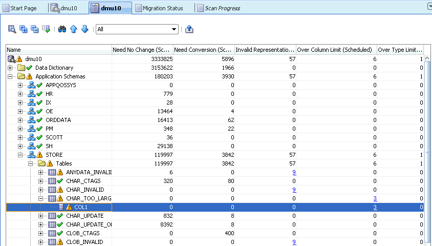

If there are expansion issues with data in your database, the Scan Report will resemble what is shown in Figure 6-14, "Database Scan Report: Expansion Issues". In addition to the columns Need No Change (Scheduled) and Need Conversion (Scheduled), described in "Cleansing Scenario 1: A Database with No Issues", the columns Over Column Limit (Scheduled) and Over Type Limit (Scheduled) contain nonzero values. A yellow triangle icon next to the database node signals convertibility issues with the data.
After conversion to the target character set, the cells classified as Over Column Limit (Scheduled) will no longer fit into their columns unless the columns are lengthened. The cells classified as Over Type Limit (Scheduled) will become longer than the limit of their data types. The lengthening of their columns will not help.
You can expand the object tree in the Name column to locate which schemas, which tables in those schemas, and which columns in those tables contain the problematic cells. The yellow triangle icons show which nodes to expand. The columns Over Column Limit (Scheduled) and Over Type Limit (Scheduled) show for each schema, table, and column how many problematic cells are in the corresponding database object.
Figure 6-14 Database Scan Report: Expansion Issues
You can also reduce the amount of information on the Scan Report tab and let the DMU show scan results only for columns that have issues. To do this, click the filter drop-down list to open it, as shown in Figure 6-15, "Filtering Scan Results". Select the option With Some Issues to see all database columns with data issues or the option With Length Issues to see only columns that have data expansion issues discussed in this section.
The non-zero counter values for Over Column Limit (Scheduled) and Over Type Limit (Scheduled) cells at the table and column level are active links. If you click a counter, it will open the Cleansing Editor tab in the client pane of the DMU window, as shown in Figure 6-16, "Cleansing Editor Tab: Expansion Issues". Another way to open this tab is to right-click the table node in the Navigator pane or the Scan Report tree and then select Cleansing Editor.

To shorten a character value in a given cell, which is marked with a yellow background in the Cleansing Editor, double-click the cell or right-click it and select Edit Data from the context menu. The Edit Data dialog box that contains the value to be edited is displayed, as shown in Figure 6-18, "Edit Data Dialog Box".
In the Edit Data dialog box, the trailing part of the character value being edited that causes the value to exceed the maximum column length after conversion is marked with a yellow background. Therefore, delete characters from the value until no yellow background is visible. You can also compare the number shown in Post-Conversion Length in Bytes with the number shown in Post-Conversion Limit in Bytes and delete characters until the first number is smaller than or equal to the second number.
After you are ready with the changes, click OK to accept the new value and close the dialog box. The new value is displayed in the Cleansing Editor but it is not yet stored in the database. You can now edit further cells. If you want to store the new values permanently in the database, click Save on the Cleansing Editor tab. You can reverse any edit changes made since the last save by clicking Revert.

In the Edit Data dialog box, you can view the binary data by looking in the bottom-right pane. The bytes comprising the edited value are displayed as 2-digit hexadecimal numbers, as shown in Figure 6-20, "Edit Data Dialog Box: Viewing Binary Data".
Figure 6-20 Edit Data Dialog Box: Viewing Binary Data
With the Cleansing Editor tab and the Edit Data dialog box open, you can now try to identify the reason for invalid binary representation issues and cleanse the issues as described in the following sections. The considerations discussed in "Refreshing Scan Results" and "Revoking Scheduled Cleansing Actions" apply to the cleansing of invalid binary representation issues as well.

If the binary view in the Edit Data dialog box does not reveal any byte patterns characteristic for binary data, the edited value is most probably character data in an incorrectly used character set. If in doubt, consult application developers or application administrators and identify the source and type of information stored in the analyzed column.
To correct incorrect character set declarations:
To identify the actual character set of data in the column, select the column in the Cleansing Editor and repeatedly change the selected value in the Character Set drop-down list, until all values in the column are legible. See Figure 6-21, "Assumed Column Character Set". To save time, apply the knowledge gathered before starting the migration, as recommended in "Review Your Preparations for Migration", to restrict the character sets to only those that can possibly be used by any data source of the database (clients, input files).
If none of the attempted character sets makes all values in the column appear to display correctly, but each of the values does seem to be correct in one of the character sets, the column contains a mixture of data in different character sets. Such issues must be resolved outside of the DMU.
After you identify the correct character set, assign it permanently to the column by clicking Save in the Cleansing Editor tab. Then, rescan the column. No more invalid representation issues should be reported for the column.
If only a very small number of values in a column is not legible in the assumed character set of the column and the characters illegible in one value are legible in another, the invalid binary representation issue results from random corruption of the character values caused by a software or hardware malfunction. In the case of software, applications that use single-byte algorithms to process multibyte data are a common reason for such corruption in multibyte databases. Such applications might split or truncate strings in the middle of a multibyte character, producing invalid partial codes.
To cleanse randomly corrupted values, edit and correct them in the Edit Data dialog box, as described in "Shortening Character Values Manually".
