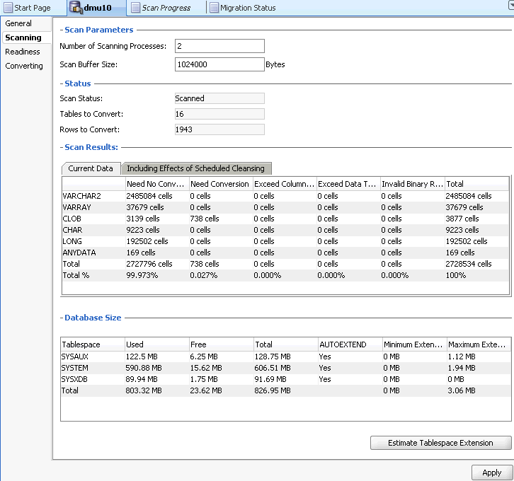

Database Properties: Scanning
On the Scanning subtab of the Database Properties tab, you can set general parameters controlling the process of scanning in this database, and view the aggregated scan results for the database. See Figure 3-2 for an illustration of the scanning subtabs.
Figure 3-2 Database Properties: Scanning
Description of Figure 3-2 follows
Description of "Figure 3-2 Database Properties: Scanning"
The properties on the scanning subtab are:
  • Number of Scanning Processes
    This specifies the number of concurrent processes used to scan the database. Each scanning process consists of a parallel thread in the DMU and a database session on the server created by this thread. The default value of the property is derived from the number of CPUs on the database server. You can tune this value by changing it and measuring the time required to complete one database scan. If you ask the DMU to scan only a small number of small tables, the number of processes used for this scan might be lower than the value of this property.
    You can also change the Number of Scanning Processes in the Scan Wizard. See "Overview of the Database Scan Report" for more information.
  • Scan Buffer Size
    This property controls the size in bytes of a buffer that the DMU allocates in each database server session to scan a table. The default value is 1000 kilobytes. The total buffer space used in a single scan is the number of scanning processes times the value of this property. Increasing the value of the property might speed up scanning but only as long as the allocated buffer memory fits into the available RAM on the database server.
    You can also change the Scan Buffer Size in the Scan Wizard. See "Scanning the Database with the Scan Wizard" for more information.
  • Scan Status
    This property shows the aggregated scan status of the database. The following values are possible:
    • Never scanned
      No scan has been performed since the most recent installation of the migration repository.
    • In progress
      A scan is currently in progress.
    • Scanned
      All tables in the database have been scanned and have valid scan results.
    • Partially scanned
      Some tables in the database have been scanned and have valid scan results, but the remaining tables either have never been scanned or their scan results have been invalidated by a cleansing action or by modification of their structure (metadata) outside of the DMU.
    • Issues found
      One or more tables in the database contain data with convertibility issues. These may be length limit (expansion) issues, invalid binary representation issues, or convertible data in the data dictionary.
    • Failed
      One or more tables in the database could not be scanned due to an unexpected error.
  • Tables to Convert
    This is the number of tables in the database that are already identified as requiring conversion during the conversion step.
  • Rows to Convert
    This is the sum of Rows to Convert property values for all tables requiring conversion in the database.
  • Scan Results
    The scan results illustrate the classification of all scanned data cells in all tables in the database into categories of convertibility. A cell is a value of a given column in a given row. The categories are:
    • Invalid binary representation
      The binary representation of the cell data is invalid under the current database character set (the converted value would contain replacement characters). This means that either the assumed character set of the column is incorrect, or the data is binary (for example, a JPEG image, an encryption result, or a text document in binary format is stored in the cell), or there are some corrupted character codes in the value.
    • Exceed data type limit
      The cell data will be too long for its data type after conversion.
    • Exceed column limit
      The cell data will not fit into a column after conversion.
    • Need conversion
      The cell data must be converted, because its binary representation in the target character set is different than the representation in the current character set, but neither length limit issues nor invalid representation issues have been found.
    • Need no conversion
      The data is fine, because the binary representation of the data does not change in the conversion.
    The cells are assigned twice into the preceding categories. The first classification, displayed under the "Current data" heading, is based on the current column definitions in the database. The second classification, displayed under the "Including effects of scheduled cleansing" heading, is based on column definitions that will result from application of the scheduled cleansing actions. Because only the second classification corresponds to errors that the data would really cause in the conversion step, this classification is used to determine if the database contents are ready for conversion. You can use the first classification as a reference to tell the convertibility status of the database contents in case all scheduled cleansing actions are deleted.
  • Database Size
    The scan result includes details about the different tablespaces:
    • Tablespace
      The name of the tablespace that was scanned.
    • Used
      The size of space in megabytes that is used.
    • Free
      The size of space in megabytes that is free.
    • Total
      The total size in megabytes of the tablespace.
    • AUTOEXTEND
      Whether the tablespace is set to automatically extend itself by a specified amount when it reaches its size limit.
    • Minimum Extension
      The minimum size in megabytes that the tablespace must be extended in order to accommodate the conversion space requirements, which assumes the best case scenario where the tables are converted sequentially one by one. It is calculated by taking into account the post-conversion data size expansion and the temporary space requirement of the largest table converted using the CTAS method.
      An empty value indicates the tablespace is not affected by the database conversion. A value zero indicates that the tablespace has enough unused space to meet the minimum conversion space requirement. A value greater than zero indicates the tablespace must be extended by that amount to meet the minimum conversion space requirement. Note that if the tablespace is auto-extensible and the device has enough free space to accommodate the extension size, then it does not need to be extended before starting the database conversion.
    • Maximum Extension
      The maximum size in megabytes that the tablespace must be extended in order to accommodate the conversion space requirements, which assumes the worst case scenario where the largest tables using the CTAS conversion method are converted at the same time. It is calculated by taking into account the post-conversion data size expansion and the temporary space requirements of the first N largest tables converted using the CTAS method (N is the number of conversion worker threads).
      An empty value indicates the tablespace is not affected by the database conversion. A value zero indicates that the tablespace has enough unused space to meet the maximum conversion space requirement. A value greater than zero indicates the tablespace must be extended by that amount to meet the maximum conversion space requirement. Note that if the tablespace is auto-extensible and the device has enough free space to accommodate the extension size, then it does not need to be extended before starting the database conversion.
  • Estimate Tablespace Extension
    Click this button to have the DMU calculate the minimum and maximum tablespace extensions for all tablespaces. Use the results as a guideline to size the tablespaces accordingly. If enough storage is available, extending the tablespaces close to the maximum extension sizes will reduce the chance of space allocation errors during the conversion phase.
    Note that the DMU does not have information of inline CLOB data that remain inline when they are converted to Unicode. For the sake of simplicity, the DMU assumes that all CLOB data are stored in LOB segments upon estimating the size of post-conversion segments.
Click Apply to save any changes made on this subtab.

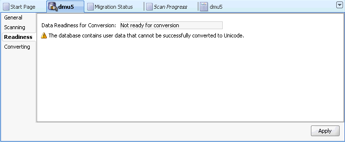

Database Properties: Readiness
This subtab shows the readiness of data for conversion. See Figure 3-3 for an illustration. The Data Readiness for Conversion property may have one of the following values:
  • Does not need conversion
    All data in the database is classified as needing no conversion, and the database passed all conversion feasibility tests described in "Preparing the Conversion".
  • Ready for conversion
    All data in the database is classified as either needing no conversion, or needing conversion, and the database passed all conversion feasibility tests.
  • Not ready for conversion
    Some data in the database is classified as having invalid binary representation or exceeding length limits, or the database has not passed some conversion feasibility tests.
If the readiness status is "Not ready for conversion", additional information is displayed to explain the problem.

Table Properties: Scanning
On the Scanning subtab of the Table Properties tab, you can control the scanning of the table, and view the aggregated scan results for columns of this table.
The properties on the Scanning subtab are:
  • Available Rowids
    This property tells if the last scan of the table collected rowids to identify rows containing cell data of a specific type. The possible values are:
    • None
      No rowids have been collected for this table.
    • All to convert
      Rowids of all rows containing at least one column value that requires conversion have been collected. These rowids are required for the conversion method "Update only convertible rows".
    • With issues
      Only rowids of rows with at least one column value with conversion issues have been collected. These rowids might improve effectiveness of working with the Cleansing Editor. See Chapter 6, "Using the DMU to Cleanse Data".
  • Rowids to Collect
    You can set this property to tell the DMU which rowids to collect during the next scan of the table. The possible values of this property are the same as for the Available Rowids property.
    You can override the value of this property in the Scan Wizard. See "Scanning the Database".
  • Split over Threshold
    Set this property to Yes to let the DMU divide the table into multiple chunks and then scan the chunks in parallel by multiple scanning processes. The DMU will split the table only if it is larger than an internally calculated threshold.
  • Done split
    The value of this property tells if the last scan of the table was performed on multiple chunks in parallel.
  • Scan Status
    This property shows the aggregated scan status of the table. The following values are possible:
    • Never scanned
      No column of this table has been scanned since the most recent installation of the migration repository.
    • In progress
      The table is currently being scanned.
    • Scanned
      All columns in the table have been scanned and have valid scan results.
    • Partially scanned
      Some columns in the table have been scanned and have valid scan results, but the remaining columns either have never been scanned or their scan results have been invalidated by a cleansing action or by modifications of their structure (metadata) outside of the DMU.
    • Results invalidated
      Scan results of all columns of the table have been invalidated by a cleansing action or by modification of the table structure (metadata) outside of the DMU.
    • Issues found
      One or more columns in the table contain data with conversion issues. These could be length limit (expansion) issues, invalid binary representation issues, or, in the case of data dictionary tables, presence of convertible data.
    • Failed
      The last scan of columns of this table failed due to an unexpected error.
  • Rows to Convert
    This is the number of rows in the table containing at least one column value that requires conversion.
  • Scan Results
    The scan results illustrate the classification of all scanned data cells in the table into conversion categories. A cell is a value of a given column in a given row. The classification is the same as that for the database except that the results are summed up for all columns of the table, not for all tables in the database. See "Scanning the Database".
    The scan results of columns whose data type is nested table are not added to the results of the table containing the column. The DMU presents the storage tables of nested table columns as separate tables.
Table Properties: Readiness
This subtab shows the readiness of table data for conversion. The Data Readiness for Conversion property might have one of the following values:
    All data in the table is classified as needing no conversion.
    All data in the table is classified as either needing no conversion, or needing conversion. The data has no conversion issues.
    Some data in the table is classified as having invalid binary representation or exceeding length limits, or some scan results are missing.
