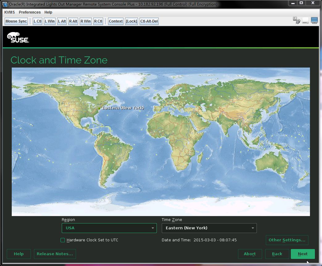

    The Clock and Time Zone screen appears.
    image:SLES 12 Clock and Time Zone screen
    Note -  If you want NTP Service, you can set that up after the operating system is installed.
  14. In the Clock and Time Zone screen, select the appropriate region and time zone, then click Next.
