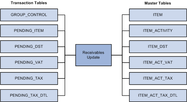

Receivables Update processes records in these transaction tables:
  • Group Control (PS_GROUP_CONTROL) - Contains header information for the transaction group.
  • Pending Item (PS_PENDING_ITEM) - Contains the transaction type and transaction detail.
  • Pending Distribution (PS_PENDING_DST) - Contains accounting entries.
  • Pending VAT (PS_PENDING_VAT) - Contains value-added tax (VAT) transaction type and transaction detail.
  • Pending Tax (PS_PENDING_TAX) - Contains India excise duty tax and sales tax entries from a billing system.
  • Pending Tax Details (PS_PENDING_TAX_DTL) - Contains India excise duty tax and sales tax details.
The process updates six master tables:
  • Item (PS_ITEM) - Contains detailed information about the receivable.
  • Item Activity (PS_ITEM_ACTIVITY) - Describes the action taken on the receivable item.
  • Item Distribution (PS_ITEM_DST) - Contains the accounting entries for the item activity.
  • Item VAT (PS_ITEM_ACT_VAT) - Contains the VAT transactions for the item activity.
  • Item Tax (PS_ITEM_ACTTAX) - Contains tax information for India for the item activity.
  • Item Tax Details (PS_ACTTAX_DTL) - Contains tax line information for India for the item activity.
Note: If you enabled the options for processing entry events selected at the installation level and on the Receivable Update Request - Options page, the Receivables Update process calls the Entry Events Generator Application Engine process (FS_EVENTGEN), which updates the Entry Event Accounting Lines table (PS_EE_ITM_ACCTG_LN) with the supplemental accounting entries.
This graphic shows the flow of data for the Receivables Update process. The transaction tables (GROUP_CONTROL, PENDING_ITEM, PENDING_DST, PENDING_VAT, PENDING_TAX, PENDING_TAX_DTL) are processed using Receivables Update and updated in the master tables (ITEM, ITEM_ACTIVITY, ITEM_DST, ITEM_ACT_VAT, ITEM_ACT_TAX, ITEM_ACT_TAX_DTL).
Image: Receivables Update process updates transaction tables to master tables
Flow of data for the Receivables Update process. The transaction tables (GROUP_CONTROL, PENDING_ITEM, PENDING_DST, PENDING_VAT, PENDING_TAX, PENDING_TAX_DTL) are processed using Receivables Update and updated in the master tables (ITEM, ITEM_ACTIVITY, ITEM_DST, ITEM_ACT_VAT, ITEM_ACT_TAX, ITEM_ACT_TAX_DTL)
Receivable Update process updates transaction tables to master tables
