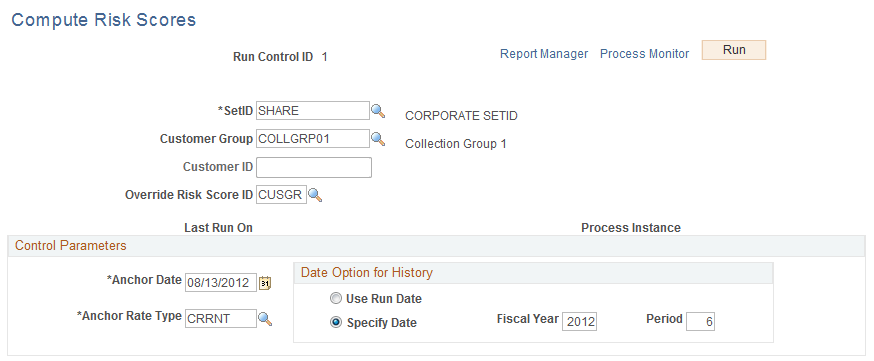

Compute Risk Scores Page
Use the Compute Risk Scores page (RUN_AR_RISK) to run the Request Risk Scoring Application Engine process (AR_RISK).
Image: Compute Risk Scores page
This example illustrates the fields and controls on the Compute Risk Scores page. You can find definitions for the fields and controls later on this page.
