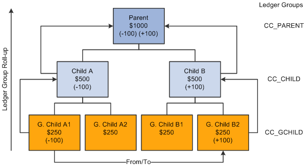

This diagram shows how a budget transfer initiated at the lowest level within a budget hierarchy is reflected at each level in the ledger groups hierarchy:
Image: Parent budget impacts generated by child budget journal transfer
In this example, 100 USD is transferred from the budget G Child A1 to budget G Child B2 within the same CC_GCHILD ledger group. Assuming that you previously set up the option to automatically generate the parent budget impacts, when the originating child journal is posted, the impact to the CC_CHILD and CC_PARENT ledger groups is automatically generated and posted to the budget ledgers for each successive ledger group in the hierarchy.
