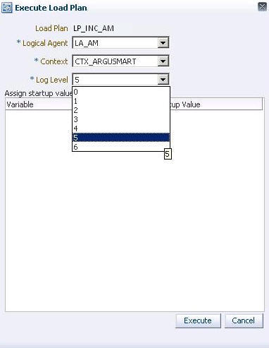

This displays the Execute Load Plan window, as shown in the following figure:
In the Execute Load Plan window:
Select LA_AM from the Logical Agent drop-down list.
Select CTX_ARGUSMART from the Context drop-down list.
Select the desired log level from the Log Level drop-down list.
Click Execute. This displays the Information dialog box with the Load Plan Execution submitted successfully confirmation message, as shown in the following figure:

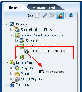

You can verify the status of the ETL process by expanding the Load Plan Executions folder in the Sessions/Load Plan Executions section. You can view the status of the Load Plan in Green color with tilted s, which signifies that the ETL session is in progress, as highlighted in the following figure:

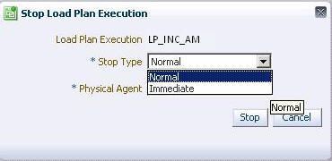

Select the Load Plan, which you want to stop, by expanding the Load Plan Executions folder of the Sessions/Load Plan Executions section and click Stop, as shown in the following figure:
This displays the Stop Load Plan Execution dialog box, as depicted in the following figure:
Select Normal from the Stop Type drop-down list.
Select OracleDIAgent from the Physical Agent drop-down list.
Click Stop. This displays the Information dialog box with the Load Plan was Stopped Successfully confirmation message, as depicted in the following figure:

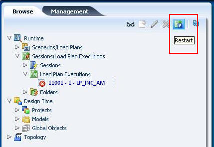

To restart the Incremental ETL, execute the following steps:
Select the Load Plan, which you want to restart, in the Load Plan Executions folder of the Sessions/Load Plan Executions section and click Restart, as shown in the following figure:
This displays the Restart Load Plan Execution dialog box, as depicted in the following figure:
Select the required log level from the Log Level drop-down list.
Click Restart. This displays the Information dialog box with the Load Plan restarted message, as depicted in the following figure:
Click OK.
This adds another Load Plan, with the same name as that of the stopped ETL, in the Load Plan Executions folder of the Sessions/Load Plan Executions section. However, this instance of the Load plan is in Green color with a tilted S, which signifies that the ETL is in progress.
