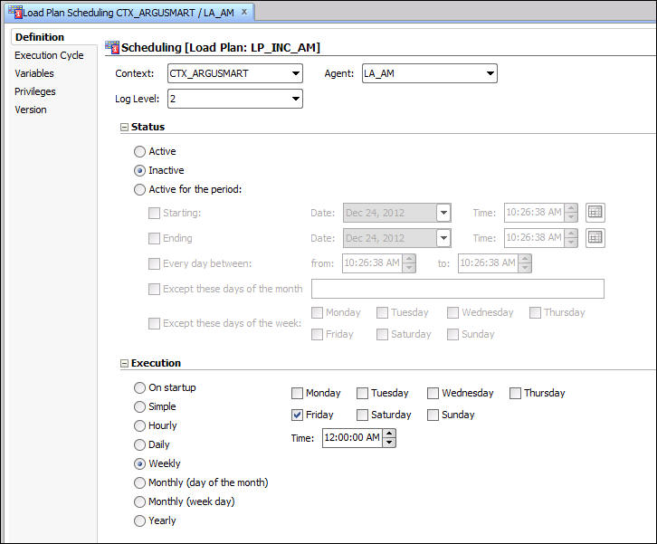

12.1 Scheduling Incremental ETL
The AM.zip file contains pre-configured ETL scheduling in Inactive mode.
The Incremental ETL is used to load the delta data. You can execute an Incremental ETL either by executing Load Plan LP_INC_AM, or scheduling an ETL to run at the configured time interval.
To schedule a Load Plan, execute the following steps:

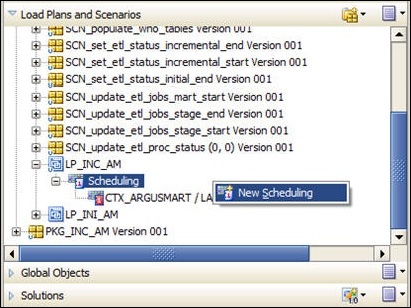

  1. In the Designer tab, navigate to Load Plans and Scenarios section and expand LP_INC_AM (Load Plan for Incremental ETL).
  2. Right-click Scheduling and select New Scheduling, as depicted in the following figure:
    Figure 12-1 Scheduling ETL
    Surrounding text describes Figure 12-1 .
    This displays the Load Plan Scheduling dialog box, as depicted in the following figure:
    Figure 12-2 Scheduling the Load Plan Dialog Box
    Surrounding text describes Figure 12-2 .
    You can set options given in the Status and Execution sections, according to the requirements to schedule the Load Plan.

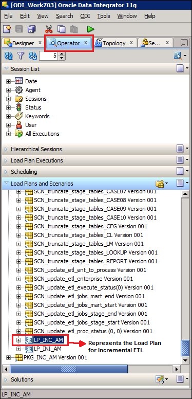

  3. Select the Operator tab in the left pane.
  4. Expand the Load Plans and Scenarios section, as highlighted in the following figure:
    Figure 12-4 Load Plans and Scenarios
    Surrounding text describes Figure 12-4 .
    The LP_INC_AM option in this section represents the load plan for the Incremental ETL process for Argus Mart.

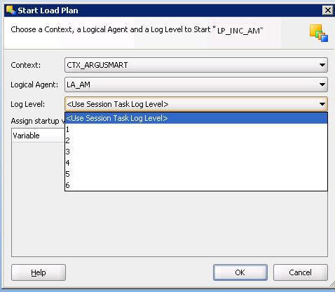

  6. Click Execute. This displays the Start Load Plan window, as shown in the following figure:
    Figure 12-6 Start Load Plan Window
    Surrounding text describes Figure 12-6 .
  7. In the Start Load Plan window:
    1. Select CTX_ARGUSMART from the Context drop-down list.
    2. Select LA_AM from the Logical Agent drop-down list.
    3. Select the desired log level from the Log Level drop-down list.
    4. Click OK. This displays the Information dialog box with the Load Plan Started confirmation message, as shown in the following figure:

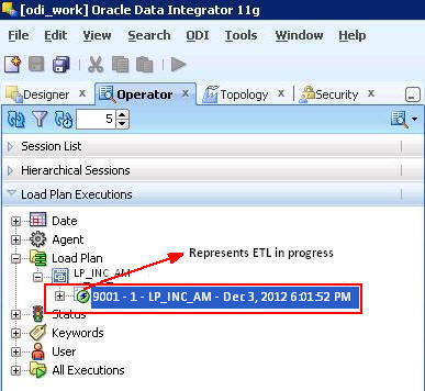

    You can verify the status of the ETL process by navigating to the Load Plan Executions section and expanding the Load Plan folder. You can view the status of the Load Plan in Green color with tilted s, which signifies that the ETL session is in progress, as highlighted in the following figure:
    Figure 12-8 Status of the Load Plan
    Surrounding text describes Figure 12-8 .

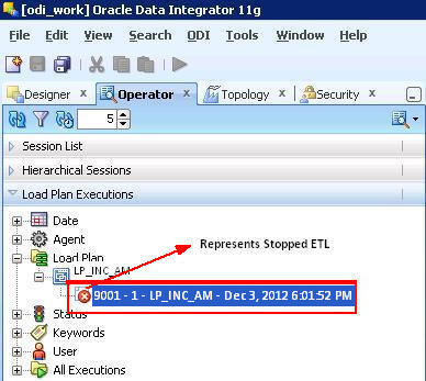

    You can verify the status of the ETL process by navigating to the Load Plan Executions section and expanding the Load Plan folder. You can view the status of the Load Plan in Red color with the X symbol, which signifies that the ETL session is not in progress, as highlighted in the following figure:
    Figure 12-11 Stopped Incremental ETL Session
    Surrounding text describes Figure 12-11 .

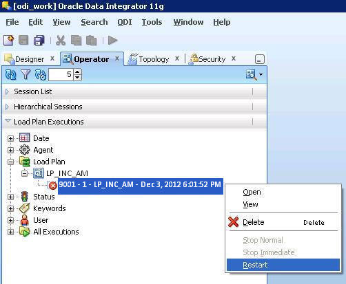

  1. Right-click the Load Plan, which you want to restart, in the Load Plan folder of the Load Plan Executions section. This displays a menu, as shown in the following figure:
    Figure 12-12 Restarting the Incremental ETL
    Surrounding text describes Figure 12-12 .

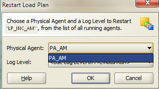

  2. Click Restart. This displays the Restart Load Plan dialog box, as shown in the following figure:
    Figure 12-13 Restart Load Plan Dialog Box
    Surrounding text describes Figure 12-13 .
  3. Select PA_AM from the Physical Agent drop-down list.
  4. Select the required log level from the Log Level drop-down list.
  5. Click OK. This displays the Information dialog box with the Load Plan restarted message, as depicted in the following figure:
    Figure 12-14 Loan Plan restarted Confirmation Message
    Surrounding text describes Figure 12-14 .
  6. Click OK.

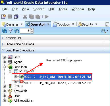

    This adds another Load Plan, with the same name as that of the stopped ETL, in the Load Plan folder of the Load Plan Executions section. However, this instance of the ETL Process is in Green color with a tilted S, which signifies that the ETL is in progress, as highlighted in the following figure:
    Figure 12-15 Restarted Load Plan
    Surrounding text describes Figure 12-15 .

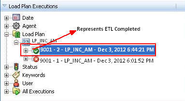

    Once the ETL process is complete, the Load Plan is displayed in Green color with a completed symbol, as highlighted in the following figure:
    Figure 12-16 Completed Load Plan
    Surrounding text describes Figure 12-16 .

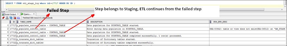

If the last execution step of the failed or stopped ETL belongs to the Staging phase, the ETL resumes from the failed or stopped point, as shown in the following figure:
Figure 12-17 Staging Phase: Incremental ETL Resumes from Failed or Stopped Point
Surrounding text describes Figure 12-17 .

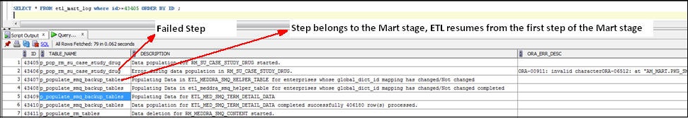

If the last execution step of the failed or stopped ETL belongs to the Mart phase, the ETL resumes from the first step of the Mart phase and not from the failed or stopped point, as depicted in the following figure:
Figure 12-18 Mart Phase: Incremental ETL Resumes from the First Step of Mart
Surrounding text describes Figure 12-18 .
