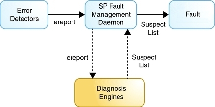

Oracle server platforms running Oracle Linux include error detectors, diagnosis engines, and response agents. Error detectors and response agents reside on the Oracle Linux host. The diagnosis engines reside on the server's service processor.
  • Error detectors detect errors in the system and perform any immediate, required handling. They also generate well-defined error reports, or ereports, to a diagnosis engine. In Linux, the mcelog daemon detects errors, and the Oracle Linux Fault Management software collects and reformats them into ereports and forwards them to the service processor for fault diagnosis.
  • A set of diagnosis engines located on the service processor interpret reports and determine whether a fault or defect is present. When such a determination is made, the diagnosis engine creates a suspect list that describes the resource or set of resources that might be the cause of the problem. The resource might or might not have an associated field-replaceable unit (FRU) or a label.
    When the suspect list includes multiple suspects, for example, if the diagnosis engine cannot isolate a single suspect, the suspects are assigned a probability as to each suspect being the key suspect. The probabilities in this list add up to 100 percent.
    Error detectors and diagnosis engines are connected by the Fault Manager daemon on the service processor, which acts as a multiplexor between the various components, as shown in the following figure.
