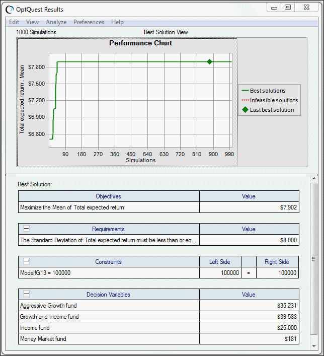

The new results are shown in Figure 34, Portfolio Allocation Optimization Results with Risk.
Figure 34. Portfolio Allocation Optimization Results with Risk
Portfolio allocation optimization results with risk.
As shown in Figure 34, Portfolio Allocation Optimization Results with Risk, OptQuest found a solution that meets the requirement well. The standard deviation of Total Expected Return is just below $8,000. The objective value, though, is now significantly lower than the previous solution without the limit on risk (Figure 30, OptQuest Results Window — Best Solution View, Portfolio Allocation Model).

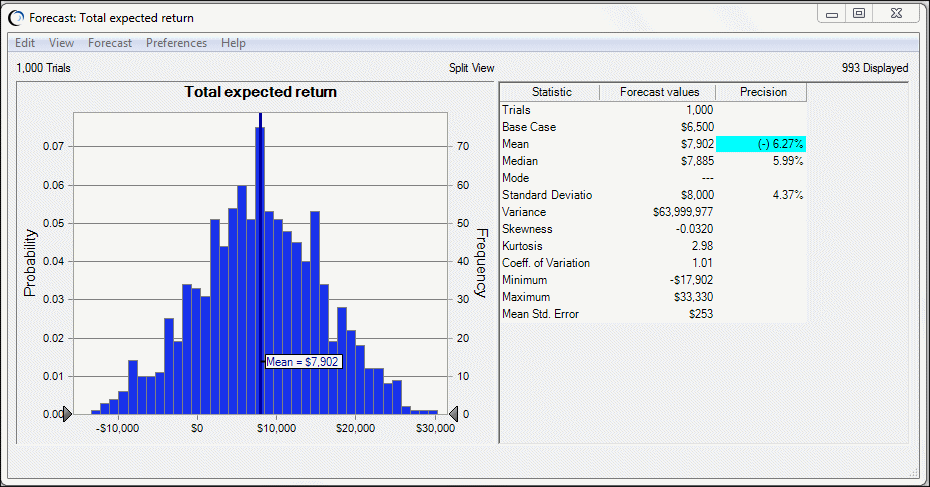

If you return to the Portfolio Allocation model and display the resulting forecast chart in Split View (Figure 35, Best Optimization Solution with Lower Risk Requirement), you can see that the new values are displayed. The standard deviation of Total Expected Return is just less than $8,000 and the coefficient of variation is slightly greater than 1.
Figure 35. Best Optimization Solution with Lower Risk Requirement
Best optimization solution with lower risk requirement.
