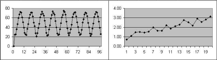

Seasonal data (increasing or decreasing in a regularly recurring pattern over time; Figure 5, Seasonal Data (Left) and Data with a Trend (Right), left side)
Trend data (consistently increasing or decreasing over time; Figure 5, Seasonal Data (Left) and Data with a Trend (Right), right side)

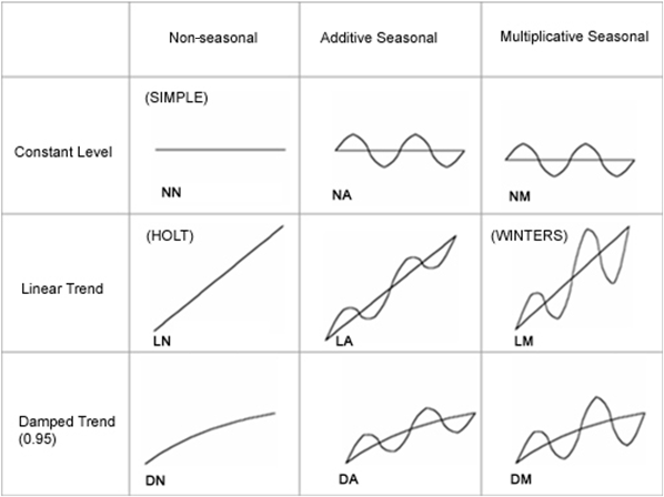

In addition to these categories, two types of seasonal methods exist: additive and multiplicative. Additive seasonality has a steady pattern amplitude, and multiplicative seasonality has the pattern amplitude increasing or decreasing over time. Damped trend methods can be non-seasonal or seasonal and show decay over time.
Figure 6, Different Method Curves illustrates the different non-seasonal and seasonal curves.
