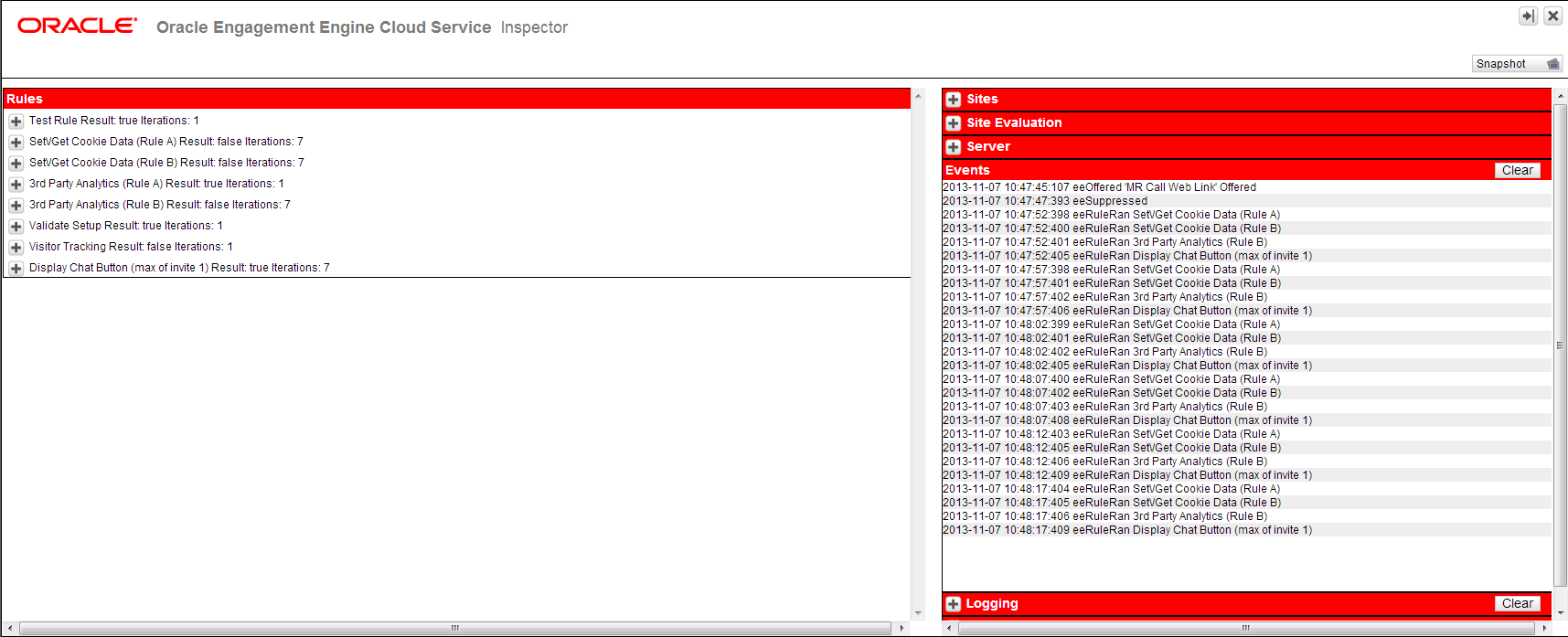

Inspector is a tool that provides you with real-time feedback about which Rules are active and how they are being evaluated. This enables you to see what is being done within a Site as a result of Engagement Engine activity. You can open the Inspector tool by following these instructions:
Click on the Settings button on the navigation bar.
Copy the contents of the Inspector Key window.
Go to your internet browser that is displaying the page on which you wish to inspect Engagement Engine activity.
Open the browser script console. The precise method of doing this depends on which browser you are using.
Paste in the Inspector key into the browser script console and run the command. This should return ‘OK’ and create a session cookie that enables the Inspector tool.
Refresh the page to activate the Inspector tool.
The Inspector tool should display on your screen when the page reloads. If the Inspector tool does not reload then check that session cookies are enabled and that an eeDebugKey session cookie has been created.
Inspector tool
The left hand side of the Inspector tool shows the Rules window. The right hand side shows a number of compressed windows that each provide further detail about Engagement Engine activity. You can expand these windows as required.
The windows that are displayed within Inspector are:
Rules: This provides technical information about the Rules that have run on this page in the current session. It displays a list of the Rules that have been evaluated. The list is displayed in the order that the Rules were initially evaluated on the page. If you click on the + button beside a Rule, Inspector displays further detail about that Rule including how often the Rule Runs, and what Conditions and Actions are associated with the Rule.

Events: This provides information about the events that have been triggered by Rules and Invites on the current page. This window updates in real-time and you can clear the contents of this window by clicking on the Clear button.

The data displayed by Inspector is live data. The information displayed in each of the windows is updated as soon as new information relevant to each window is generated.
You can take a snapshot of the current data by clicking on the Snapshot button. This creates a new tab which contains all of the information in each of the windows as it was when the button was pressed. Inspector can capture a maximum of 5 snapshot tabs at any one time.
