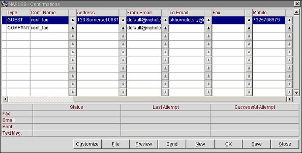

You may select letter recipients, designate communication methods, preview and customize letters, and monitor letter printing or transmission progress from the Confirmations screen.
The following information is presented on this screen.
Print, Email, Fax, Text Msg. Communication role, or method. An X in any of these columns indicates that the method has been selected for sending confirmation/reservation update/cancellation communications to the person or entity identified in the Name column. In order for a method to be selected, the appropriate address information must be provided. See Adding and Editing Communication Methods, below.
Name. Name of the confirmation/update/cancellation letter recipient. The recipient can be the individual guest, or the company, source, agent, contact, or group attached to the reservation.
Type. The type of profile for this letter recipient (guest, company, source, group, contact, or agent). A confirmation letter can be sent to the Caller if the RESERVATIONS > CALLER INFORMATION application function is set to Y.
Conf. Name. File name of the letter template. Select the down arrow to choose from the letter templates available to you. The list is ordered alphabetically by the report Description. Any reports that do not have a Description are listed first.

Address. Mailing address of the recipient, if you choose to use the print communication method. Select the down arrow to display the List of Addresses. Choose the address you wish to use, or select New Address to specify a new address and add it to the profile. A screen appears prompting you for the new address information.
From Email. The e-mail address of the user, department, or other entity that sent the e-mail. To determine which e-mail address populates in this field, the system will use the following sources and priorities:
Note: After a confirmation has been e-mailed, if the confirmation needs to be re-sent and the e-mail address that was used in the 'From Email' field has since been deleted from the system, you must select a new e-mail address from the 'From Email' field list of values.
To Email. Email address for the recipient if you choose to use the email communication method. The confirmation /reservation update/ cancellation letter is rendered as a PDF attachment (an RTF attachment if the letter is customized) and delivered directly to the recipient's email account. The address designated as the primary email address appears here by default. Select the down arrow to display the List of Email Addresses. Choose the address you wish to use, or select New Email Address to specify a new address and add it to the profile. A screen appears prompting you for the new address information. See Adding and Editing Communication Methods, below, for more information.
Fax. Fax number for the recipient if you choose to use the fax communication method. The confirmation/reservation update/cancellation letter is delivered directly to the recipient's fax phone number. The address designated as the primary fax address appears here by default. Select the down arrow to display the List of Fax Phone Numbers. Choose the number you wish to use, or select New Fax to specify a new number and add it to the profile. A screen appears prompting you for the new phone number information. See Adding and Editing Communication Methods, below, for more information.
Mobile. Available when the GENERAL > TEXT MESSAGE HANDLING application function is set to Y, select the mobile number for the recipient if they choose to receive a text message.
Optional Email. (Available when the RESERVATIONS > CONFIRMATION OPTIONAL EMAIL application parameter is set to Y.) You can enter an optional email address under this column to send the reservation confirmation to another recipient. This email address will not be linked to the profile for which the reservation was created.
Note: The Optional Email for the confirmation will not be exchanged between ORS/PMS.

Status. The current processing status. PENDING means that the printing (for print letters) or transmission (for email or fax letters) has not been attempted. This can be because the printer or the email or fax interface is not configured or is currently not online. (PENDING can also indicate that you did not select the particular communication method.) SUCCEEDED means that the letter was printed or that the fax or email was sent to the fax or email server.
Note: SUCCEEDED does not necessarily mean that the fax or email letter reached its destination. Actual delivery or delivery failure can only be ascertained by reviewing server records.
Last Attempt. The date of the most recent attempt.
Successful Attempt. The number of letters successfully printed (for print letters) or sent to the email or fax server (for fax and email letters). For example, if three faxes were successfully sent to the fax server, the number 3 would appear in this column of the Fax row. Zero appears here if the processing is PENDING.
