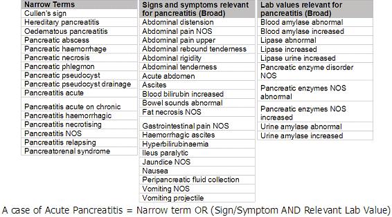

Standardized MedDRA Queries (SMQs) are designed to aid in the identification and retrieval of case safety reports in clinical studies. The MedDRA Maintenance and Support Services Organization (MSSO) defines SMQs as follows:
SMQs are groupings of terms from one or more MedDRA System Organ Classes (SOCs) that relate to a defined medical condition or area of interest. They are intended to aid in case identification. The included terms may relate to signs, symptoms, diagnoses, syndromes, physical findings, laboratory and other physiologic test data, etc., related to the medical condition or area of interest. Lowest Level Terms (LLTs) that are not subordinate to an included Preferred Term (PT) are excluded.
See Figure 6-1, "Acute Pancreatitis SMQ Terms and Algorithm" for an example of a MedDRA SMQ.

MedDRA SMQs may use one or more of the following design features:
  • Broad and Narrow. SMQ relations with dictionary terms may be identified as broad or narrow. Narrow terms are highly likely to represent the condition of interest while broad terms help to identify all possible cases, including some that may prove to be of little or no interest. A broad search retrieves broad terms. A narrow search retrieves narrow terms.
    To support broad and narrow SMQ searches in TMS, define and load broad and narrow named relations from SMQ terms to base dictionary terms.
  • Algorithm. Algorithms within SMQs are used to further define combinations of specific terms based on rules defined in an algorithm that can be processed programmatically during a search operation.
    To support SMQ algorithms, define an Informative Note of type Algorithm for SMQ terms with algorithms; see "Defining Informative Notes for SMQ Algorithms".

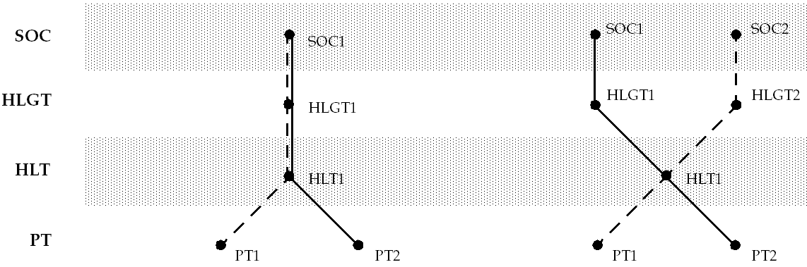

Primary Links and Primary Path Links
If you define a relation where a term in Lower Level B can be linked to many terms in Higher Level A (Many cardinality), you can specify that each term in Lower Level B must have a Primary Link to a single term in Higher Level A. If the relation is on the derivation path—levels from which TMS can derive terms to be sent to an external system—you must require a Primary Link. Otherwise, TMS cannot activate the dictionary.
When a Primary Link is required, it is possible to create a Domain Primary Link for a particular term to override its Global Primary Link within a particular domain.
When you define a group level, you can define primary relations from terms outside (and below) the group level to the group level in two different ways:
  • Primary Link. If you define a Primary Link to the group level, and Many cardinality is defined on the higher side of level relations, the lower-level term can have links to multiple terms on multiple levels in the group level, but only one link can be the Primary Link. The Primary Link can be between the lower-level term and a single term on any level within the group level.
  • Primary Path Link. If you define a Primary Path Link to the group level, a term in the lower level can have links to multiple terms in multiple levels within the group level, but it must have a Primary Link to a term in the lowest level within the group, and to a related term in the next highest level, all the way to the top level.
    You must load or define the Primary Link for each lower-level term to a term in each of the group levels from the bottom up. TMS restricts your choices at each level to terms that are related to the Primary Link term in the immediately lower level. Thus, different lower-level terms can have a Primary Link to the same term in the lowest group level but different terms in the higher group levels (see Figure 6-2).
    Primary Path Links are designed to accommodate MedDRA's structure.
See "Grouping Levels" for background information on group levels.
Figure 6-2 shows derivation paths using Primary Link (on the left) and a primary path (on the right). In these examples, all relations between levels are many-to-many, so Primary Links are required for each relation in the derivation path.
  • The example on the left shows a dictionary structure without a group level, where a Primary Link is required between each level and the next higher level. Terms PT1 and PT2 are both defined with a Primary Link to the same term—HLT1—in the next higher level. Their derivation path is the same because the rest of the derivation path depends on the Primary Links defined for the higher-level terms: HLT1 has a single Primary Link to HLGT1, which has a single Primary Link to SOC1.
  • The example on the right shows a dictionary structure where the HLT, HLGT, and SOC levels are all included in a group level, but a primary path is defined between the PT level and the group level. In this case, terms PT1 and PT2 can be linked to the same term in the HLT level and yet be linked to different terms in the two higher levels. This model conforms to MedDRA's structure.
Note that there is a third possible structure. If you defined the same group level as in the example on the right—containing the SOC, HLGT, and HLT levels—and defined a Primary Link from the PT level to the group level instead of a Primary Path Link, then the terms PT1 and PT2 would each link to HLT1 but, if Many cardinality were defined from the HLT to the HLGT and from the HLGT to the SOC, their derivation path would end there. No higher level terms could be derived because no other Primary Links or primary paths would exist.
If Single cardinality were defined from the HLT to the HLGT and from the HLGT to the SOC, and those levels were defined as reportable and their relations as derivable, the derivation path would continue all the way to the SOC level.
Figure 6-2 Derivation Path Examples for MedDRA
Description of Figure 6-2 follows
Description of "Figure 6-2 Derivation Path Examples for MedDRA"

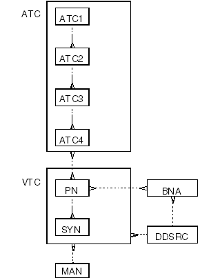

Grouping Levels
You can arrange levels of a strong dictionary into a group level, and define other levels as having a relation with the group level rather than one or more of its sublevels. You can then define individual terms as having relations with terms in sublevels within the group level. This enhances efficiency and functionality by:
  • Eliminating unnecessary duplication of terms in more than one level. By enforcing uniqueness of terms throughout the VTC group level in Figure 6-3, for example, you can ensure that no duplicate terms exist between the PN and SYN levels.
  • Allowing you to define a Primary Link requirement to the group level as a whole; when you define specific Primary Links for terms from outside the group level to the group level, you can choose to create the Primary Link to a term in any one of the group's sublevels.
For example, you could define WHO-Drug as shown in Figure 6-3, with two group levels, ATC and classification level VTC:
Figure 6-3 Group Levels in a Sample WHO-Drug Dictionary
Description of Figure 6-3 follows
Description of "Figure 6-3 Group Levels in a Sample WHO-Drug Dictionary"
This definition of WHO-Drug makes use of the Group Level feature as described in the following two sections.

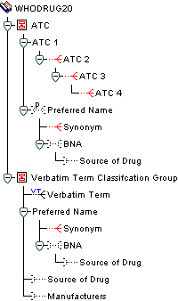

Tree Structure Display of Group Levels
Group levels do not fit easily into a standard tree structure display. TMS displays them as follows:
  • If a group level exists below the top of the hierarchy, its sublevels are displayed twice: once below the group level, which is displayed as a sibling level to the level above (because it cannot be defined as a child level), and once directly under the higher level with the relation between the top sublevel and the higher level displayed.
  • The Group Level icon is displayed to the left of the group level.
  • The relation icons (lines, dotted lines, and branches) appear in color for all sublevels within a group except the topmost, which by definition cannot have a conventional relation defined to the group level.
This display is for a sample WHO-Drug dictionary as shown in Figure 6-4.
Figure 6-4 Sample WHO-Drug Dictionary in the TMS Navigator Tree
Description of Figure 6-4 follows
Description of "Figure 6-4 Sample WHO-Drug Dictionary in the TMS Navigator Tree"

  7. Define the parent side of the relation. Select or leave deselected each box as it relates to the parent side of the relation.
    It may help to diagram the relation, indicating whether each end is either multi or single, and either mandatory or optional.
    For example, to define the relation shown below, leave both the Mandatory? and Many Cardinality? boxes clear for the parent level, and select both those boxes for the child level.
    Description of manycrd1.gif follows
