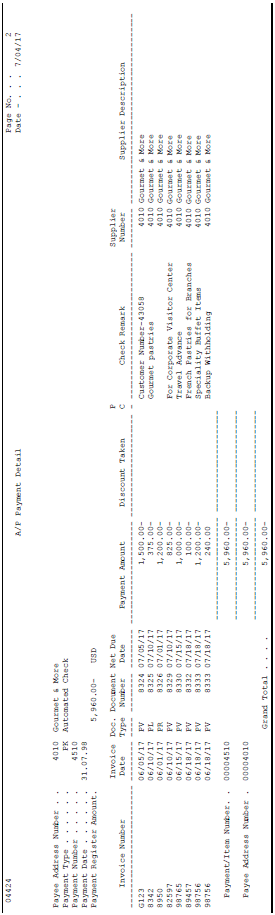

The Payment Detail report shows voucher detail for all payments for a selected supplier. Print this report to determine which vouchers have been paid.
The payment header and voucher detail information is from the A/P Matching Document join table (F0413JA), a join table of the Address Book Master (F0101), A/P Matching Document (F0413), and A/P Matching Document Detail (F0414) tables.

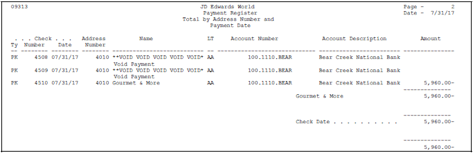

For audit purposes, you might need an additional copy of a payment register. The Payment Register report is similar to the register that prints during automatic payment processing. However, the payment information on this register is summarized, instead of detailed. This register also lists multi-stub payments and payments that were voided due to a reset.
You can choose whether to print the Alpha Name or the Mailing Name of the supplier as shown in the payment detail section of the report by processing option selection.
Use P09313 to select print options such as output queue, form type, and save or hold print file.
Figure 52-2 Payment Register Total by Address Number and Payment Date report

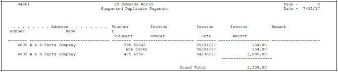

Prior to payment processing, you might want to identify any duplicate vouchers. If the A/P constants are not set to allow for editing duplicate supplier invoice numbers when you enter vouchers, print the Suspected Duplicate Payments report.
Information on this report is from the A/P Ledger table (F0411). Vouchers appear on this report based on one of the following criteria:
Duplicate invoice number
Duplicate amount within an invoice
This report does not adjust the status of any vouchers listed.
Figure 52-3 Suspected Duplicate Payments report

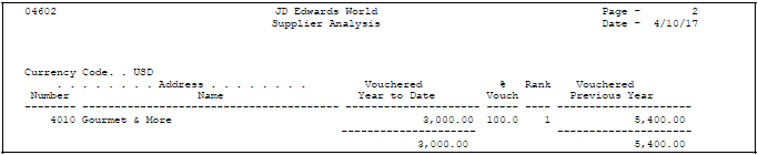

To view a supplier's transaction activity, print the Supplier Analysis report. This report lists suppliers in descending order according to their year-to-date vouchered amount. The voucher amounts on this report are gross amounts less any taxes.
Print this report after you run Update YTD Voucher Amount, P04820. If you do not, the Supplier Analysis report shows information only as of the last time it was run.
Information on this report is from the Address Book (F0101) and the Supplier Master table (F0401).

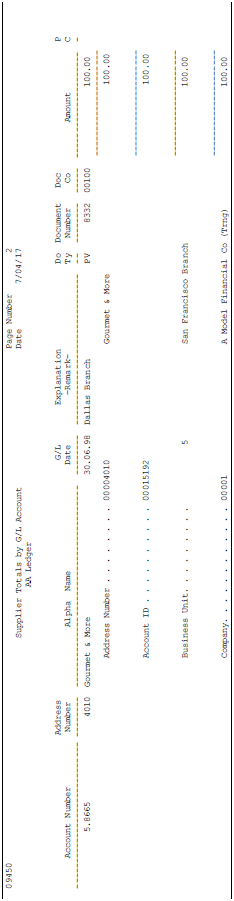

To analyze which suppliers provide specific types of services and products based on G/L distributions, print the Supplier Totals by G/L Account report. This shows G/L account detail information and totals by supplier from the Account Ledger table (F0911).
Figure 52-5 Supplier Totals by G/L Account AA Ledger
