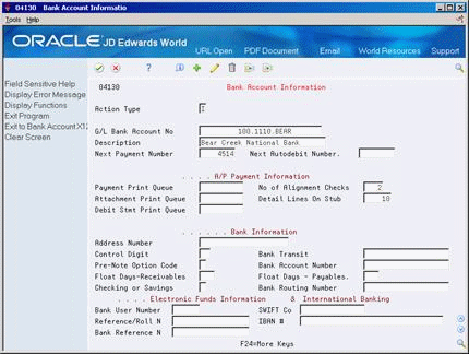

To set up bank account information for payments
Figure 74-1 Bank Account Information screen
Complete the following fields:
G/L Bank Account Number
Description
Complete the following optional fields:
Next Payment Number
Next Auto Debit Number
Payment Print Queue
Attachment Print Queue
Debit Statement Print Queue
Number of Alignment Checks
Detail Lines on Stub
Address Number
Control Digit
Bank Transit
Pre-Note Option Code
Float Days - Receivables
Float Days - Payables
Checking or Savings
Bank Routing Number
SWIFT Code
IBAN
If you use drafts or BACS, complete the following fields:
Bank User Number
Reference/Roll Number
Bank Reference Name

On Bank Account Information, use the Add action.
| Field | Explanation |
| Next Payment Number | The system updates the next available payment number during automatic payment print processing. |
| Payment Print Queue | This is the print output queue for A/P payments.
Form-specific information You can define three print queue fields on this form:
If you leave a print queue blank, the system uses the print queue specified by your user profile. |
| No of Alignment Checks | The number of checks that are needed at the start of check printing in order for the check stock to be aligned properly on the printer. |
| Detail Lines On Stub | Detail Lines per A/P Payment Stub (SDTL) field controls the number of detail lines that appear on an A/P payment stub. The JD Edwards World hardcopy payment formats are written and formatted to a specific form size. For example, the payment formats, such as S04572 and S04572C allow a maximum of 10 detail lines per stub. Although the Detail Lines on Stub field accepts any two digit numeric value, you must create a custom check format program to utilize this feature. |
| Control Digit | This is an optional field that allows you to enter a check digit for a bank account number. The check digit is not part of the key to the Bank Account table (F0030). |
| Pre-Note Option Code | The code used to override the Pre-Note processing for electronic funds transfers. Valid values are:
blank Use the Pre-Note code assigned to the supplier. 1 – Override the Pre-Note code assigned to the supplier and produce a bank tape with no check output even if the Pre-Note code is set to P. |
| Float Days - Payables | Future Use - The number of days the check floated. This is defined by subtracting the check date from the bank deposit date.
The value date is calculated by adding the float days to the payment date. |
| Checking or Savings | A flag that indicates whether the account is a checking or savings account. This indicator is only meaningful on the G type bank account records and is used during bank tape processing for automatic payments.
Valid values: blank – checking account 0 – checking account 1 – savings account |
| Bank Routing Number | The Bank Routing Fraction Number in an identifier that typically appears in the upper right-hand corner of the check. It is usually in the format 9999- 9999/9999 and identifies the bank and bank branch. Similar to the Transit Number. |
| SWIFT Code | The Society for Worldwide Interbank Financial Telecommunications (SWIFT) code is an international banking identification code used to identify the origin and destination of electronic (or wire) financial transfers. |
