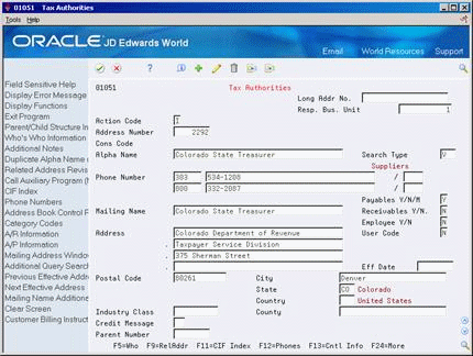

To set up a tax authority for withholding
If you are required to report or pay withheld taxes to a particular tax authority, you must set up that tax authority in the address book.
Navigation
From Accounts Payable (G04), enter 29
From Accounts Payable Setup (G0441), choose A/P Tax Setup
From Tax Processing & Reporting (G0021), choose Tax Authorities
On Tax Authorities
Figure 26-1 Tax Authorities screen
Description of Figure 26-1 follows
Description of "Figure 26-1 Tax Authorities screen"
Complete the following fields:
  • Alpha Name
  • Mailing Name
  • Search Type
Field Explanation
Search Type A user defined code (01/ST) that identifies the kind of address book record you want the system to select when you search for a name or message. For example:
E – Employees
X – Ex-employees
V – Suppliers
C – Customers
P – Prospects
M – Mail distribution lists
Form-specific information
When you enter Address Book information for a new employee, the system automatically enters E in this field.

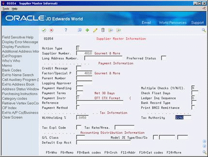

To set up a supplier for withholding
If you are required to withhold a percentage of each payment to a particular supplier, you must set up that supplier for withholding. The system will deduct the percentage you specify from each voucher you enter. It will also make that percentage payable to the tax authority you specify.
Although you can specify the tax authority in the Supplier Master record (F0401), the system also provides a processing option in the Calculate Withholding (P04580) program that you can use to override the tax authority that you specify here.
Navigation
From Accounts Payable (G04), choose Supplier & Voucher Entry
From Supplier & Voucher Entry (G0411), choose Supplier Master Information
On Supplier Master Information
Figure 26-2 Supplier Master Information screen
Description of Figure 26-2 follows
Description of "Figure 26-2 Supplier Master Information screen"
  1. Locate the supplier.
  2. Complete the following fields in the Tax Information area:
    • Withholding Percent
    • Tax Authority
  3. Click Change.
Field Explanation
Withholding Percent The rate of U.S. withholding tax to be retained from payment to a supplier. This number is expressed as a whole decimal. For example, 20% would be expressed as .2000.
Tax Authority for A/P Withholding A code that identifies the government agency for which you withhold taxes from supplier payments.
