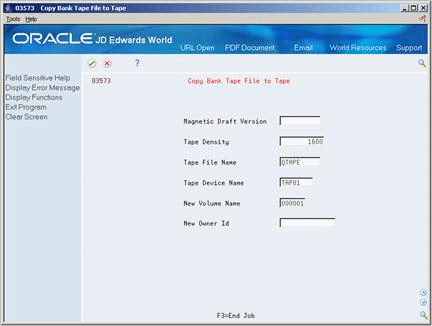

To copy a draft table to tape
On Copy Bank Tape File to Tape
Figure 57-2 Copy Bank Tape File to Tape screen
Description of Figure 57-2 follows
Description of ''Figure 57-2 Copy Bank Tape File to Tape screen''
Accept the default information in the following fields, or make any changes necessary:
  • Magnetic Draft Version
  • Tape Density
  • Tape File Name
  • Tape Device Name
  • New Volume Name
  • New Owner ID
Field Explanation
Magnetic Draft Version Identifies a group of items that the system can process together, such as reports, business units, or subledgers.
Tape Density The density of the tape to be created, for example, 1600, 6250, and so on.
Tape File Name The identification (such as program number, table number, and report number) that is assigned to an element of software.
Tape Device Name The device name, for example, QTAPE5 for tape device, TAP01 for cassette device, and so on. If you entered form type O, this represents your production library for the work file.
New Volume Name The new volume.
New Owner ID The new owner ID.

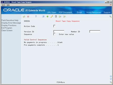

57.1.6 Resetting the Draft Tape Copy Sequence for A/R
You might need to re-copy an existing bank tape table to tape or diskette if, for example, the tape was lost or damaged in transit to the bank. In order to re-copy the tape, you must reset the tape sequence. You might also need to reset the tape sequence if you need to re-create the tape table, for example, to include an additional draft.
When the system creates a bank tape table, it sets the Sequence field to 1, which prevents the system from changing the table. When you copy the bank table to tape, the system changes this field to blank. Reset Tape Copy Sequence resets the sequence control code in the Bank Tape Sequence table (F04926) to blank so the system can re-create the table.
To reset the draft tape copy sequence for A/R
On Reset Tape Copy Sequence
Figure 57-3 Reset Tape Copy Sequence screen
Description of Figure 57-3 follows
Description of ''Figure 57-3 Reset Tape Copy Sequence screen''
  1. To locate a bank tape table, complete the following fields:
    • Version ID
    • Member ID
  2. Remove the value from the following field:
    • Sequence
Field Explanation
Version ID The A/P payment version that corresponds to the DREAM Writer version selected in A/P payment processing.
Form-specific information
This is the DREAM Writer version ID you used to create the tape table on Magnetic Tape Remittance.
Member ID The identification (such as program number, table number, and report number) that is assigned to an element of software.
This is the program number that created the tape table. For A/R drafts, the member ID is P03572.
Sequence Used to ensure that the proper sequence of events occur in draft processing. Valid values are:
blank – Table has been copied to tape
1 – Table has been created but not yet copied to tape

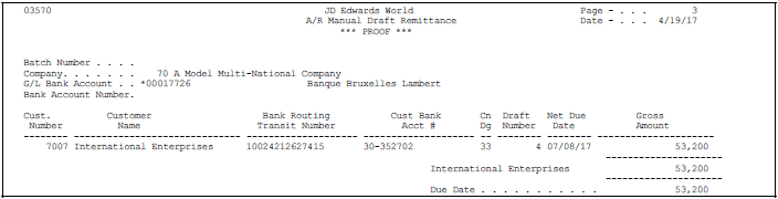

57.2.1 Running Paper Draft Remittance
There are four versions of the Paper Draft Remittance program to run in proof or final mode with or without a Register.
Proof mode Final mode With or Without Register
In proof mode, the program:
  • Selects drafts accepted but not yet submitted to your bank for collection
  • Prints register reports
In final mode, the program works in the same way as proof mode except that it also:
  • Changes the payment status to G (guaranteed)
  • Creates journal entries to debit the drafts remitted account and credit the drafts receivable account
Choose the appropriate version depending on whether or not a register was created. The data selection determines which draft records will be created based on the draft's pay status.
Caution: DO NOT change the data selection values for pay status as doing so will cause incorrect remittance records.
If you manually created a draft register, you can run a version of Paper Draft Remittance that prints the register. If you have not created a register, you can run a version of this report that creates the register.
When you run this program, the system edits the G/L date against the company date for the drafts receivable and drafts remitted accounts.
For paper draft remittances, the system only reports drafts with payment instrument 3 (supplier draft without bank account number) or with payment instrument 4 (customer draft without bank account number).
When you enter drafts with full bank account information, the system places a Y in the Print field. The Paper Draft Remittance program selects drafts with Print not equal (NE) to Y. Changing the payment instrument for a draft to 0, 1, or 2 does not change the Print field. Therefore, changing the payment instrument does not cause the system to select a draft that was originally entered with a payment instrument of 0, 1, or 2.
JD Edwards World recommends that you run this report in proof mode before running it in final mode. This allows you to review and correct errors prior to updating records. If the system finds errors when running the report in final mode, it prints an error message on the report and does not create journal entries.
This program reads information from the A/R Ledger table (F0311).
Figure 57-4 A/R Magnetic Draft Remittance (A/R Ledger Table) report
Description of Figure 57-4 follows
Description of ''Figure 57-4 A/R Magnetic Draft Remittance (A/R Ledger Table) report''
