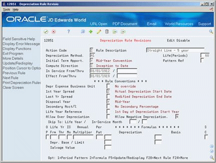

On Depreciation Rule Revisions
Figure 24-1 Depreciation Rule Revisions screen
Description of Figure 24-1 follows
Description of "Figure 24-1 Depreciation Rule Revisions screen"
  1. Complete the following fields:
    • Life (Periods)
    • Initial Term Apportionment
    • Compute Direction
    • In Service From/Thru (Date From/Date Thru)
    • Effective From/Thru
    • Pattern Reference
  2. Enter the appropriate code in the following field:
    • Depreciation Method

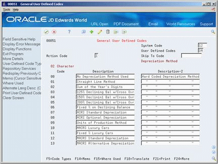

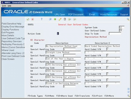

To revised user defined codes
Navigation
From General systems (G00), choose General User Defined Codes
On General User Defined Codes
Figure 24-2 General User Defined Codes screen
Description of Figure 24-2 follows
Description of "Figure 24-2 General User Defined Codes screen"
  1. Enter an alphabetic, two-character code in the following field:
    • User Defined Codes
  2. Choose More (F24).
    Figure 24-3 General User Defined Codes (Detail) screen
    Description of Figure 24-3 follows
    Description of "Figure 24-3 General User Defined Codes (Detail) screen"
  3. To identify the depreciation method as a user defined method, complete the following field:
    • Special Handling Code
  4. To return to Depreciation Rule Revisions, choose Exit Program.
  5. On Depreciation Rule Revisions, complete the following field with the code for the depreciation method to which you want to add the rule:
To define the conventions of the depreciation rule, complete any of the following fields:
  • Depreciation Expense Business Unit
  • First Year Spread
  • Last Year Spread
  • Disposal Year
  • Secondary Account/%
  • Life Year Reference
  • Allow Over Depreciation
  • Allow Negative Depreciation

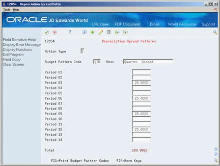

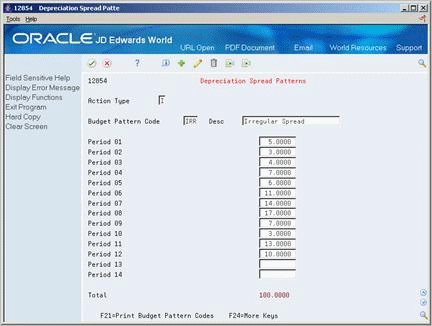

  3. On Depreciation Spread Patterns, to add a new spread pattern, complete the following fields:
    • Budget Pattern Code (Per Pat)
    • Desc
    • Period 01-14
  4. Choose Exit Program.
  5. On Depreciation Rule Revisions, to attach the spread pattern to the rule, enter 1 (Period Pattern) in the following field:
    • OP (Option)
  6. On Depreciation Spread Patterns, complete the following field:

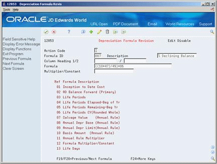

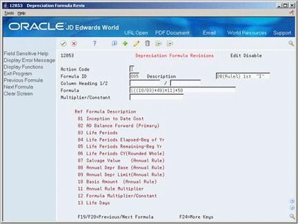

To define formulas for the rule
  1. Choose Formula.
    Figure 24-5 Depreciation Rule Revisions (Define Formulas) screen
    Description of Figure 24-5 follows
    Description of "Figure 24-5 Depreciation Rule Revisions (Define Formulas) screen"
  2. On Depreciation Formula Revisions, to define a new formula, complete the following fields:
    • Formula ID
    • Description
    • Formula
    • Multiplier/Constant

1 – Responsible Business Unit
2 – Location Business Unit
3 – Work Center Business Unit
1st Year Spread A code that designates how you want the system to apportion the first year of depreciation for an asset. Valid codes are:
Blank – Modified Depreciation Start Date
1 – Entire Year
2 – Actual Depreciation Start Date
3 – Placed in Service Period
Last Yr Spread A code that designates how you want the system to apportion the last year of depreciation for an asset. Valid codes are:
blank – Modified depreciation end date
1 – Entire year
Disposal Year A code that designates how you want the system to apportion depreciation when you dispose of the asset.
Valid codes are:
blank – To End of Disposal Period
A – Actual Disposal Date
Y – Mid-Year
Q – Mid-Quarter
M – Mid-Month
P – Middle of Period
F – First-Half / Second-Half
L – Last Day of Previous Period
I – Inverse of Initial Term Apportionment
N – None
Secondary Acct/% A code that designates how the system uses the amount calculated by the Secondary Account/Percent rule when determining the annual depreciation amount. Valid codes are:
blank – No secondary percentage
1 – Greater of amounts calculated by Rule 1 or Rule 2
2 – Lesser of amounts calculated by Rule 1 or Rule 2
6 – Amount from Rule 1 to Accumulated Deprecation Account 1; amount from Rule 2 to Accumulated Deprecation Account 2
7 – Amount from Rule 1 to Accumulated Deprecation Account 1 plus Depreciation Expense Account 1 equals Rule 1 amount; amount from Rule 2 to Accumulated Deprecation Account 2 plus Depreciation Expense Account 2 equals Rule 2 amount
8 – Two Amounts - Two A/D Accounts and Three D/E Accounts
The system uses this field in conjunction with the Secondary Percent Continuation field.
Life Year Reference A code that designates the beginning reference point from which you want the system to determine the current life year of an asset. Valid codes are:
blank – 1st day of depreciation start year
1 – Depreciation start date (modified)
Allow Over Depreciation A code that indicates whether you want the system to allow over depreciation for an asset. Use this field when you want the system to allow depreciation in excess of the basis, or when you want to allow depreciation beyond the period you define as the life of the asset, as in the ACRS Luxury Autos depreciation method. Valid values are:
blank – Over depreciation NOT allowed during asset life, take remaining basis at end of asset life
1 – Accumulated depreciation may EXCEED adjusted basis during asset life, take remaining basis at end of asset life
2 – Over depreciation NOT allowed during asset life, allow depreciation beyond asset life
3 – Accumulated depreciation may EXCEED adjusted basis during and beyond asset life
The default for this field is blank. The system uses this field in conjunction with the Allow Negative Depreciation field.
Allow Negative Depreciation A code that indicates whether you want to allow depreciation formulas to calculate negative amounts. Valid codes are:
N – Negative depreciation not allowed
Y – Accumulated depreciation may be less than adjusted basis
You can enter a 1 for yes (Y) or a 2 for no (N). The default value is N.
Asset Life Year - Start The first asset life year to which the rule pertains. You must set up detail annual rules for a depreciation rule, beginning with year 1 and extending through every year in the life of the asset. The system does not allow "gaps" between years.
You can set up the detail annual rules beyond the life of the asset. A single record may represent several contiguous years, but the system does not allow duplicate years.
Valid values are 1 through 998, and 999. Use 999 only to set up a specific rule for the disposal year of an asset.
Asset Life Year - Through The last year in the life of an asset to which the rule pertains. You can set up the detail annual rules beyond the life of the asset. Each rule must have a rule for contiguous years beginning with 1. A single record can represent several contiguous years, but the system does not allow duplicate years.
IS Mo This field refers to the month the asset is placed in service. You can specify rules by inclusive ranges. When you use the value of blank, the system continues to use the annual rule for the last specified placed in service month until it finds a higher placed in service month value.
The system uses the values you enter in this field as follows:
  • First, the system searches for an exact match. (For example, if an asset is placed in service in month 01, the system looks for a Placed In Service Month value of 01 for that year.)
  • If an exact match does not exist, the system searches for a value of blank.
  • If a value of blank does not exist, the system continues to use the annual rule for the last specified placed in service month for a range of months until it finds the next highest month you specify.
For example, if you set up annual rules for the Placed In Service Months of 01, 03, 06, and 09, the system uses the rule you specify for 01 during the first and second months, the rule you specify for 03 during the third, fourth, and fifth months, the rule you specify for 06 during the sixth, seventh, and eighth months, and the rule you specify for 09 for the remaining months.
Valid values are blank, 01, 02, 03, 04, 05, 06, 07, 08, 09, 10, 11, and 12.
Annual Multiplier A percentage that you can use as an element within a formula, or by itself. The system applies this percentage to the basis of an asset to derive depreciation. If no basis is defined for the asset, then the system applies this percentage to the cost.
Enter a value in this field as a decimal. For example, enter 10% as .10 and 150% as 1.5.
Per Pat The code for a specific depreciation spread pattern. A pattern determines how the annual depreciation amount is to be apportioned to periods within a year. You can designate spread patterns for individual years, or for a group of years.
Secondary % Continuation Use this code to indicate whether an annual depreciation rule is a primary or secondary rule.

24.3 Setting Up Depreciation Formulas
You can define or revise depreciation formulas. You can then attach the formulas to the elements of the depreciation equation in a life year rule. Use the four basic mathematical functions (+ - * /) and parentheses for nesting amounts or quantities to construct depreciation formulas in algebraic format.
The Fixed Assets system includes codes that you can use to represent the elements that the system uses to retrieve the related amounts or quantities from the Item Balance table, Item Master table, Date Pattern table, and so on. For example, you can define a depreciation method that is based on a formula that you create to subtract salvage value from cost.
A comprehensive list of the elements that you can use to define formulas to include in depreciation rules appears in Appendix A.
You can access the Depreciation Formula Revision screen directly from the menu, or you can access the screen from Depreciation Rule Revision. For example, if you are revising depreciation rules, and you want to update a formula associated with the rule, you can access Depreciation Formula Revision to review and revise formulas you have previously defined without exiting from the Depreciation Rule Revision program.
User defined depreciation formulas must have alphabetic identifiers to distinguish them from standard depreciation formulas. You can modify only the alpha formulas, but you can use the numeric formulas as a starting point to create your own formulas with alphabetic identifiers.
To set up depreciation formulas
Figure 24-7 Depreciation Formula Revision screen
Description of Figure 24-7 follows
Description of "Figure 24-7 Depreciation Formula Revision screen"
  1. To set up or locate an existing formula, complete the following field:
    • Formula ID
    Choose the field sensitive help for Formula ID to review a list of valid formulas or to search for a specific formula by code or description.
  2. To revise or define the formula, complete the following fields:
    • Description
    • Formula
Field Explanation
Formula The system uses the formula you enter in this field to calculate an amount for an associated formula ID. You can attach the formulas you define on Formula Revisions to the Depreciation Rule Revisions screen. You can define the following depreciation formulas:
  • Multiplier
  • Basis
  • Base
  • Limit
  • Salvage value
Formulas can include a combination of formula elements listed on the Depreciation Formula Revisions screen, the four basic mathematical functions, and parentheses for nesting amounts or quantities. Use the following valid symbols for these basic mathematical functions:
+ – Addition
- – Subtraction
* – Multiplication
/ – Division
( ) – Left and right parentheses
Multiplier/Constant A percentage or amount that can be incorporated into a formula as an element to derive depreciation.
24.4 Setting Up Depreciation Spread Patterns
When you run depreciation, the system calculates an annual depreciation amount. Then, the system calculates depreciation for a particular period based on a percentage. You set up period pattern spread rules to specify how you want to recognize the annual deprecation amount within a year. If you do not set up a spread pattern for your depreciation rule, the system spreads the annual depreciation amount equally among the normal number of periods that you set up for your organization.
You can enter spread amounts for periods 01 through 14. The total of the spread percentages that you enter must sum to 100 before the system will allow the pattern to be added or an existing pattern changed.
The system stores depreciation spread patterns in the Depreciation Spread Pattern table (F12854).
To set up depreciation spread patterns
Figure 24-8 Depreciation Spread Patterns (Set Up) screen
Description of Figure 24-8 follows
Description of "Figure 24-8 Depreciation Spread Patterns (Set Up) screen"
  1. To set up or locate a depreciation pattern code, complete the following field:
  2. To define or revise a depreciation pattern code, complete any of the following fields:
    • Period 01-14
Field Explanation
Period 01 Enter the percentage of depreciation you want to record for the asset in the first period. You can enter spread percentages as:
  • Whole numbers (such as 20 for 20%)
  • Whole numbers with a decimal, where the decimal is a fraction of the percentage (such as 50.5 for 50 1/2%)
  • Zero or blank, for no percentage
You can enter spread percentages for up to 14 periods. The total of the spread percentages must sum to 100.
Note: You set up the default periods for the fiscal year on Date Pattern Revisions for company 00000.
