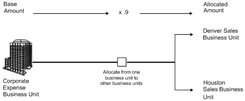

With cost allocations, you can:
Allocate an amount from only one business unit to one or more business units.
Allocate an amount to more than one contra/clearing account. This feature is unique to this method.
Multiply by a positive or negative rate before allocating.
Create recurring journal entries.
Set up periodic budgets.
The following graphic illustrates how an amount can be allocated from one business unit to one or more business units using cost allocations.

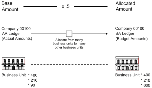

This type of allocation is the most flexible and most commonly used because of its copy feature. For example, you can copy this year's actual amounts to next year's budget. With this method, you can also:
Allocate from one company to another.
Multiply by a positive or negative factor before allocating.
Set up either annual or monthly budgets.
Convert currencies. For example, you can restate U.S. dollars to Canadian dollars for consolidated reporting with other Canadian companies.
Create allocations transaction by transaction in the general ledger or update account balances in the Account Balances table (F0902).
You can also enter any gain or loss on the conversion to a contra/clearing account. Although the system has this capability, JD Edwards World recommends that you use financial restatement instead of allocations to convert currencies.
The following graphic illustrates how amounts can be allocated from business units in one company to business units in the same company using indexed allocations.
For example, to set up an allocation using the indexed method for the photocopier, you could distribute the expense based on a fixed percentage of use for each department.

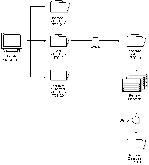

Steps to Process an Allocation
For each type of allocation, use the following process:
Figure 1-4 Steps to Process an Allocation
The following graphic illustrates how an allocation creates journal entries for the AA (actual amounts) ledger.
Figure 1-5 How an Allocation Creates Journal Entries for the AA (actual amounts) Ledger

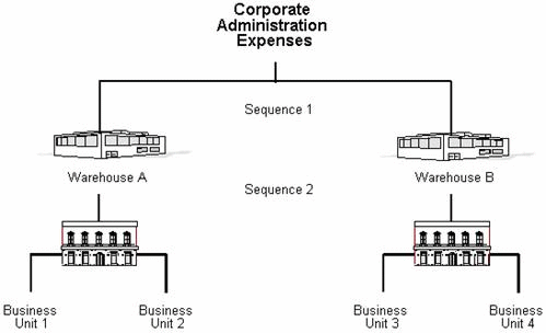

All allocations can create multiple tiers of allocations (also known as compound or cascading allocations) if you define the calculation sequence. Subsequent calculations use the allocation amounts from previous tiers. You can have up to nine tiers.
The following graphic illustrates multi-tiered allocations.
Sequencing is necessary:
When all of the corporate costs are passed through the warehouses to the business units
When warehouse costs (not just corporate costs) are allocated to the business units
The system can perform calculations sequentially only if all calculations in the sequence use the same type of allocation. If you want to use different types for sequential calculations, you must compute each calculation separately and in the correct sequence.
