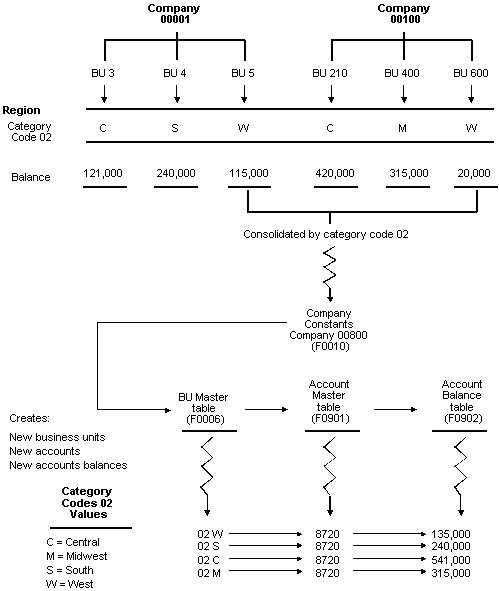

25.1.1 Example: High-Volume Consolidation
In this example, the following business units are grouped together under the West Region:
  • Business unit 5, associated with company 1
  • Business unit 600, associated with company 100
During high-volume consolidation, these two business units are consolidated into a pseudo business unit named 02W, where:
  • 02 represents category code 02
  • W represents the category code value for West Region
The following diagram illustrates a high-volume consolidation that consolidates data by region using business unit category code 2.
Figure 25-1 Consolidation by Region Using Business Unit Category Code 2
Description of Figure 25-1 follows
Description of "Figure 25-1 Consolidation by Region Using Business Unit Category Code 2"

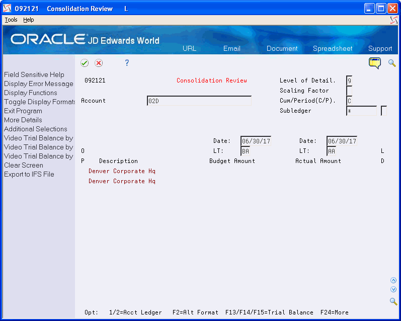

To review high-volume consolidations
On Consolidation Review
Figure 25-2 Consolidation Review screen
Description of Figure 25-2 follows
Description of "Figure 25-2 Consolidation Review screen"
  1. Complete the following field:
    • Account
  2. To view detail in different formats, choose Toggle Display Formats (F2) to view the following formats:
    • Budget and actual amounts for the period
    • Budget and actual amounts, and the difference between them
    • Budget and actual amounts for the period and year-to-date
  3. To review additional detail, perform any of the following:
    • Choose Video Trial Balance (F13/14/15), for single-ledger views of the data.
    • Enter 1 or 2 in the Option field for Account Ledger Inquiry.
    • To view and change enhanced subledgers, choose Additional Selections (F6).
On Trial Balance/Ledger Comparison complete the business unit field and click find. Only journal entries made directly to the pseudo business unit appear because refreshing consolidations creates only balances, not transactions
