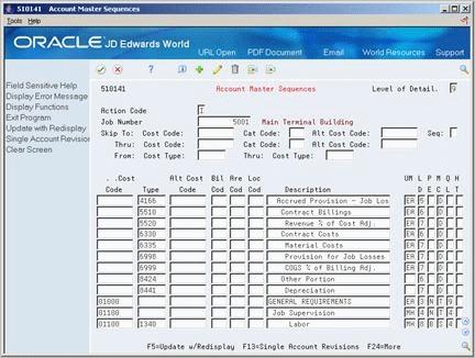

From Job Cost (G51), choose Job & Budget Setup
From Job & Budget Setup (G5111), choose Account Master Sequences
You can assign an alternate sequence manually to each line item of a cost code structure after you create it. You can do this by assigning a predefined alternate sequence category code to each account or by assigning an alternate cost code number to each account.
You must define the alternate sequence category codes.
On Account Master Sequences, locate the job by completing the following field:
Job Number
Figure 8-1 Account Master Sequences screen
Complete the following field:
Sequence
Complete one of the following optional fields for each line item:
Alternate Cost Code
Billing Code
Area Code
Location Code
| Field | Explanation |
| Subsidiary - Alternate | An alternate subsidiary account that allows you to comply with a regulatory chart of accounts, parent company requirements, or third party coding scheme. |
| Sequence Code | Controls the sequence of the accounts that are displayed.
Valid codes are: Blank – Cost code and cost type 1 – Category code 01 2 – Category code 02 3 – Category code 03 A – Alternate cost code |

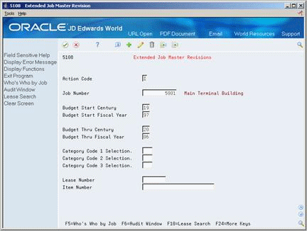

From Job Cost (G51), enter 29
From Job Cost System Setup (G5141), choose Extended Job Master Revisions
You can direct your system to automatically create an alternate sequence based on predefined category codes when you create the cost code structure for a job.
To assign category codes automatically
On Extended Job Master Revisions, locate the job by completing the following field:
Job Number
Figure 8-2 Extended Job Master Revisions screen
Complete the following optional fields:
Category Code 1 Selection
Category Code 2 Selection
Category Code 3 Selection
| Category Code 1 Selection | Specifies the characters that the system selects from the cost code of an account to create category code 01 for that account. The system does this automatically when the account is added to the Account Master file (F0901). Since a cost code can be up to eight characters, the valid characters are 1-8. You use a plus sign (+) to specify an imbedded blank in a category code.
For example, suppose you add accounts with the cost codes 03100, 05120, and 12100.
If you do not want to use the automatic selection feature for any category code 01, leave this field blank. Note: This feature is also available in the processing options for Global Update - Alternate Sequence. Screen-specific information The Category Code 2 Selection and the Category Code 3 Selection fields are used to specify the characters that the system selects from the cost code of an account to create category codes 02 and 03, respectively, for that account. |
