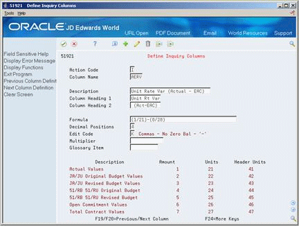

You must define the columns you use on Job Status Inquiry to display your information. When you define a column, you can specify the following:
  • Column name
  • Column heading
  • The formula by which the information displayed in the column is calculated
  • The glossary item name in the data dictionary
The information is stored in the Inquiry Columns table (F5192).

  1. Complete the following fields:
    • Column Name
    • Formula
  2. Complete the following optional fields:
    • Description
    • Column Heading 1
    • Column Heading 2
    • Decimal Positions
    • Edit Code
    • Multiplier
    • Glossary Item

Formula A calculation that the system uses to input an amount or quantity in this column. You can use a single predefined value or multiple predefined values in conjunction with mathematical operators to enter a formula. Valid mathematical operators are:
+ – Add
- – Subtract
* – Multiply
/ – Divide
( ) – Left and right parentheses for nesting
For example, you can enter the following formula to have the system calculate on-time percentages:
20/(20+21+22)
The formula above equals on-time percentages because:
  • 20 is the value for on-time amounts
  • 21 is the value for early amounts
  • 22 is the value for late amounts

Formula codes The system uses each code described in the table to retrieve a related amount or unit quantity. The codes, which are user defined (51/FM and IL), identify the ledger or group of ledgers that are the source of the information. You must match the following fields with the appropriate codes:
  • For amounts, the valid codes are 1 - 20.
  • For unit quantities, the valid codes are 21 - 40.
  • For header units, the valid codes are 41 - 60.
  • For percent complete, the valid code is 61.
Formula examples The following list includes examples of different ways you can combine the codes and mathematical functions to create formulas:
  • Actual amount: 1
  • Actual unit rate: 1/21
  • Total commitments: 1+6
  • Unit rate variance: (1/21) - (5/25)
The formula consists of a single code if the column relates to a specific value contained in the ledger.

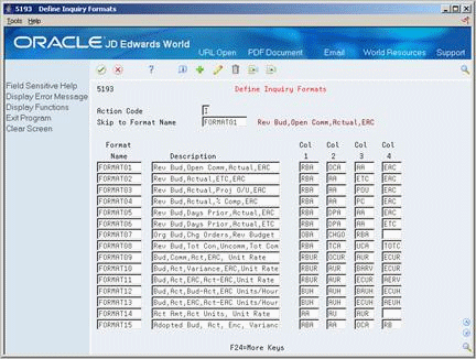

After you define the columns for Job Status Inquiry, you can group them into formats. A format can include up to four columns, which appear on Job Status Inquiry in the same order you define them in the format. You are not required to assign a column to each of the four column fields. The format definitions are stored in the Inquiry Formats table (F5193).
To define inquiry formats
On Define Inquiry Formats
Figure 53-2 Define Inquiry Formats screen
Description of Figure 53-2 follows
Description of ''Figure 53-2 Define Inquiry Formats screen''
Complete the following fields for each format:
  • Format Name
  • Description
  • Column 1
  • Column 2
  • Column 3
  • Column 4

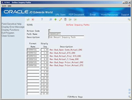

After you define the formats for Job Status Inquiry, you can group them into paths. A path is a sequence of more than one format through which you can toggle to view your information. The path definitions are stored in the Inquiry Paths table (F5194).
After you define your paths, you can rearrange the formats into a new sequence.
Complete the following tasks:
  • Define an inquiry path
  • Rearrange formats
Figure 53-3 Define Inquiry Parts screen
Description of Figure 53-3 follows
Description of ''Figure 53-3 Define Inquiry Parts screen''
To define an inquiry path
On Define Inquiry Paths
    • Path Name
    • Description
  2. Complete the following field for each format in the path:
    • Format Name
    • Sequence Number
