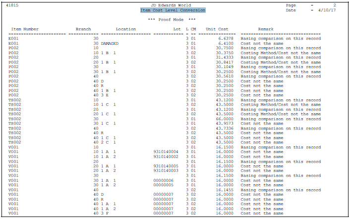

You can run the Item Cost Level Conversion program in proof or final mode. When you run the procedure in proof mode, the system provides you with a report showing errors that need correction. You should always run the procedure in proof mode first to clear any discrepancies.
Figure 55-1 Item Cost Level Conversion report
Description of Figure 55-1 follows
Description of "Figure 55-1 Item Cost Level Conversion report"
The report includes the following information:
  • Whether errors occurred or if the update process was successful
  • The number of items successfully updated
  • The number of items in error
If an error occurred, the report indicates:
  • The record used for the comparison, if appropriate
  • The specific error, which prints after the comparison line
If the cost level changed from a 3 to 2, 3 to 1, or 2 to 1, the report identifies:
  • Cost level
  • Costing method
  • Cost columns
When you run the procedure in final mode, the system:
  • Updates the Item Master table (F4101) Inventory Cost Level value (CLEV)
  • Updates the Cost Ledger table (F4105)
