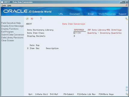

On Data Item Conversion
Figure 54-1 Data Item Conversion screen
Description of Figure 54-1 follows
Description of "Figure 54-1 Data Item Conversion screen"
  1. Complete the following fields:
    • Data Dictionary Library
    • Data Item Class
Field Explanation
Data Dictionary Library The name of a library defined on the AS/400.
Data Item Class Data item class. A class defines the essential attributes and characteristics of a data item. Informational only.
Display Decimals Use this parameter to designate the number of decimals in the currency, amount, or quantity fields the system displays. For example, U.S. Dollars would be 2 decimals, Japanese Yen would be no decimals, and Cameroon Francs would be 3 decimals.

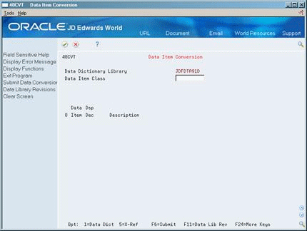

To convert data items
  1. Confirm that all data items for which you want to change decimal positions appear in the list.
  2. Choose Submit (F6) to activate the conversion process.
    The job that you submit will have the same name as the data item category specified.
    After you run the conversion program, and before you allow users back onto the system, check your data thoroughly to ensure that the conversion worked for each of the data libraries.
