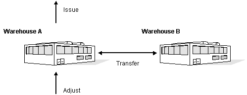

When you issue inventory, you remove it from a location. When you adjust inventory, typically you move it from one location to another to reconcile a discrepancy between the number of items that are recorded at a location and the actual count. Another scenario is adjusting inventory out of a location when there are damages to items. When you transfer inventory, you move it from one location to another.
Figure 7-1 Moving Inventory - Three Scenarios
Description of Figure 7-1 follows
Description of "Figure 7-1 Moving Inventory - Three Scenarios"
How you enter transaction information depends on the item and your specific business environment. For example, you can issue, adjust, or transfer items by entering quantity, cost amount, or quantity and cost amount information. Performing transactions by the cost amount helps you accommodate variances that are due to different costing methods that are used in different branch/plants.

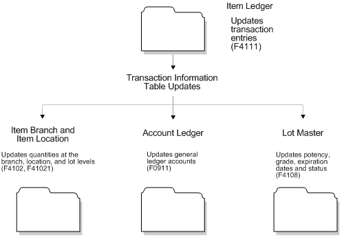

7.2.1 Where Does the System Record Transactions?
The system records each transaction in the Item Ledger table (F4111) and updates information in the following tables:
Figure 7-2 Where Item Transaction Information is Stored
Description of Figure 7-2 follows
Description of "Figure 7-2 Where Item Transaction Information is Stored"
