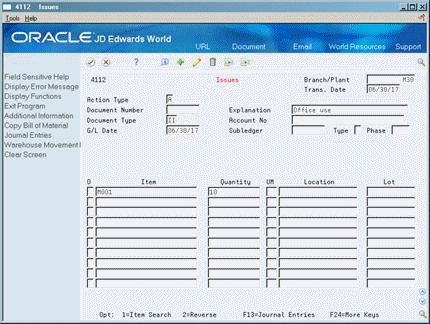

To issue inventory, you must enter transaction, item, and accounting information. You can also enter issue-related information for each branch/plant in which an item is stored.
You can choose from several online formats to record and track different types of issues:
Standard format - Issue inventory items from a branch/plant.
Equipment format - Record inventory that is issued to a specific piece of equipment.
Subledger format - Debit a specific general ledger account for an issue.
Equipment and subledger format - Record the specific piece of equipment that was issued to a job and debit a specific general ledger account for an issue.
You can choose alternate formats and default values in the processing options. Cost, lot, and accounting information might not display, depending on how you have set up the processing options. If lot information displays, the format depends on how you have set up duplicate lot processing in System Constants.

To enter transaction information, complete the following fields:
Branch/Plant (Business Unit)
Trans. Date (Transaction Date)
Document Type
Explanation

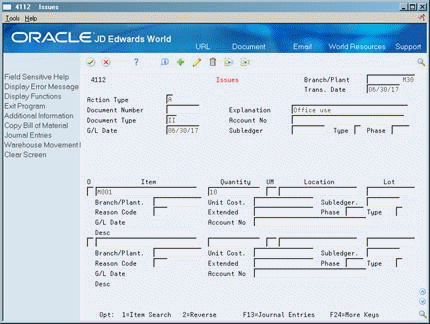

To enter issue information for each branch/plant that the item is stored, access the detail area.
Complete the following fields:
Item (Number)
Quantity
UM
Location
Lot
Unit Cost (Amount-Unit Cost)
Reason Code
Extended (Amount of Extended Cost)
If you are using subledger-based accounting, complete the following additional fields:
Account No. (Account Number-Input)
G/L Date (Date-For G/L)
Subledger (Subledger-G/L)
Type (Subledger Type)
Phase
The system processes the transaction and displays a document number, document type, and the batch number for the transaction.
Note: The screens used in this step have subledger-based accounting set up in the program processing options. If the processing options are set up for standard issues, the fields in step 4 do not appear. |
