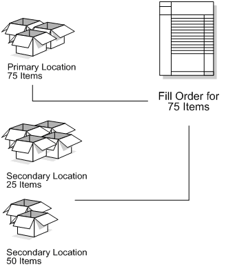

After you enter a sales order, the system commits inventory for it. At the time of order entry, you can choose the type of commitment that you want to use.
| Commitment | Description |
| Soft commitment | When you use soft commitments, the system:
| Hard commitment | When you use hard commitments, the system:
Note that this occurs most frequently during shipment confirmation, but can occur at any time during the sales order process. |
| Future commitment | When you use future commitments, the system:
| Other Quantity 1 and 2 | When you commit inventory for other quantities, the system:
The following diagram shows how the Inventory Management system typically commits inventory. You can use additional commitment methods if you are using lot processing. For example, you can define the commitment method by lot number or lot expiration date.
Figure 11-1 How the System Commits Inventory
