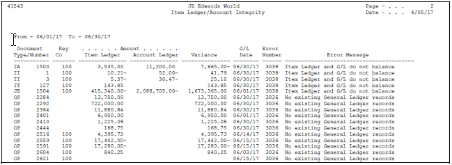

Item Ledger/Account Integrity is a DREAM Writer report (P41543) that displays discrepancies between the Item Ledger (F4111) and Account Ledger (F0911) tables.
The report displays the following types of discrepancies:
Item ledger detail exists with no corresponding general ledger detail.
Item ledger does not balance with the corresponding general ledger detail.
The report displays summary lines that represent specific totals:
Document type
Document number
Key company
The report also displays the solution to the discrepancies. A blank report indicates that there are no discrepancies.

Figure 21-1 Item Ledger/Account Integrity report

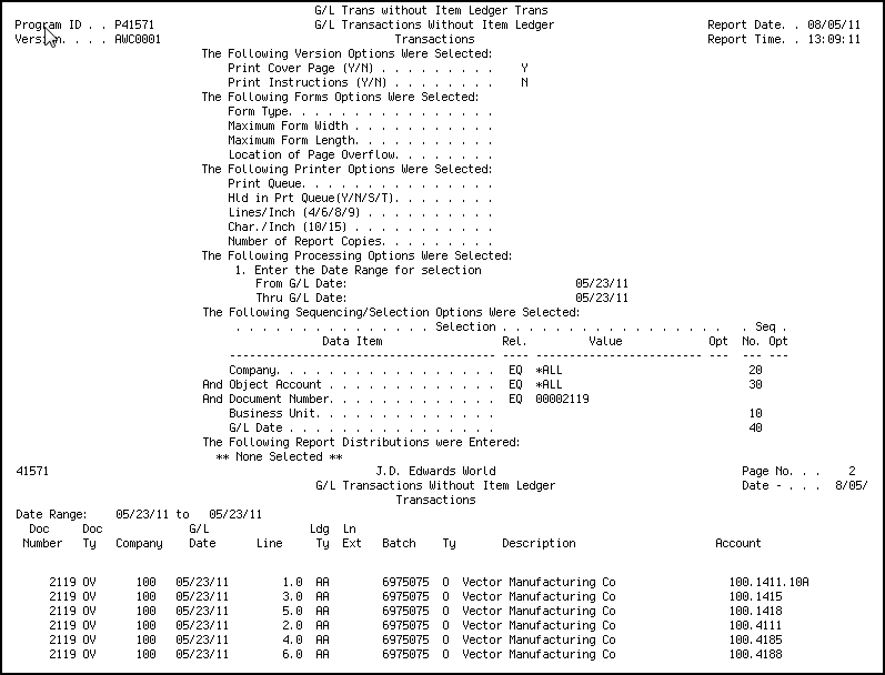

Account / Item Ledger Integrity is a DREAM Writer report (P41571) that compares the G/L transactions (F0911) to the Item Ledger transactions (F4111). The report lists those G/L transactions without corresponding Item ledger transactions.
G/L Inventory records without corresponding Item Ledger records.
Document Number
Document Type
Company
G/L Date
If you select incorrect or invalid data, the system displays error details including error number and short description on the report.
If you do not select records, the report prints with a No Records Selected message.
Run the report with the processing options set to include a specified date range.
Run the report with data selection set to object account range.
Figure 21-2 G/L Transactions Without Item Ledger report

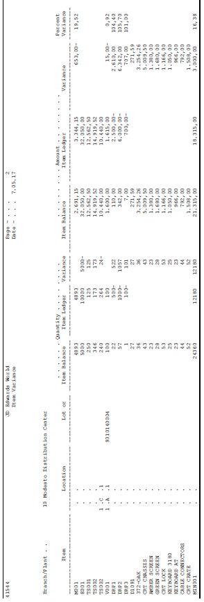

Item Balance Ledger Integrity is a DREAM Writer report (P41544) that displays discrepancies for both quantity and amount between the Item Balance (F41021) and Item Ledger (F4111) tables, in combination with the Item As Of table (F41112).
Branch/plant
Item number
Location
Lot number
A blank report indicates that there are no discrepancies, unless you have set the processing option to print all records.

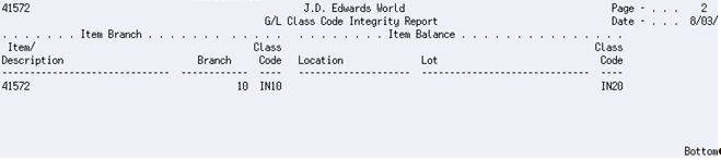

General Ledger Class Code Integrity is a DREAM Writer report (P41572) that displays discrepancies in G/L Class Codes between Item Location (F41021) and Item Branch file (F4102). .Codes that differ are printed on the report.
Branch/plant
Class Code
Location
Lot number
Figure 21-4 G/L Class Code Integrity report

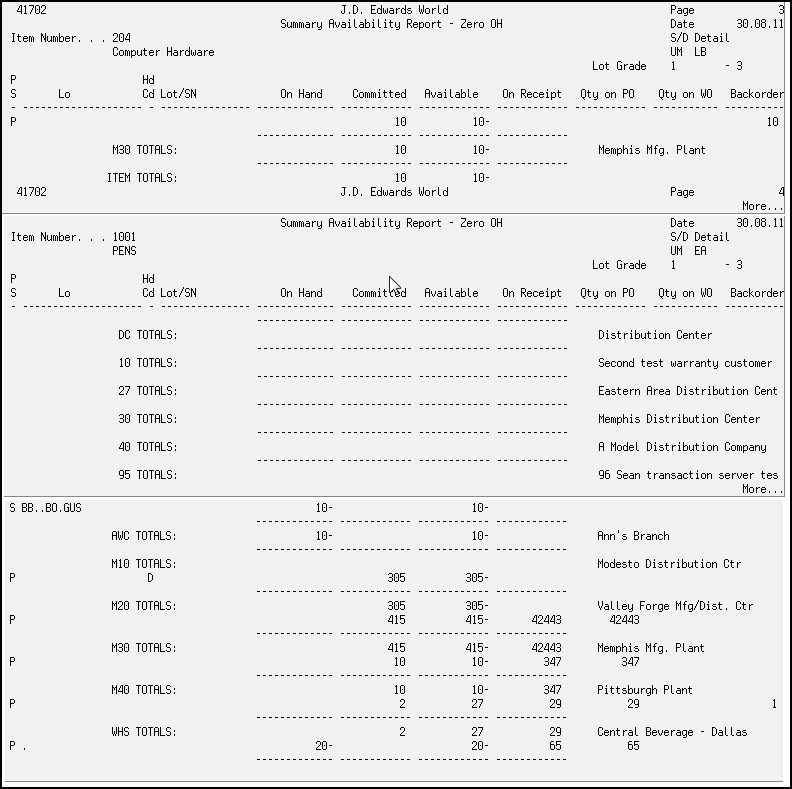

Summary Availability Report (0/Neg) is a DREAM Writer report (P41702) that displays records with zero and negative on - hand balances. When invalid data is selected you will see error details including error number and description.
Location
Lot number
On Hand
Committed
Available
On Receipt
Qty on PO
Qty on WO
Backorder
