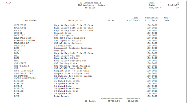

20.1 Reviewing the ABC Analysis Report
From Inventory Management (G41), choose Inventory Reports
From Inventory Reports (G41111), choose ABC Analysis
The ABC Analysis report is based on the principle that a small number of items will account for the largest part of a company's business. A slightly larger number of items will account for a smaller, but significant amount of business. The remaining large number of items, taken together, will account for only a small amount of business.
You can generate an ABC Analysis report based on an item's total sales, gross margin, or on-hand value. The ABC analysis report ranks inventory items with a letter grade of A, B, or C (where A represents the items with highest total sales, largest gross margin, or largest on-hand value). You can also use different ranking percentages in each category. For example, the system could rank Item A based on percentage of sales and Item C based on gross margin. The information that the ABC Analysis report provides helps you to determine which items control your inventory costs and profits.
You can use the ABC Analysis as the basis for inventory cycle counts (in which A items are counted more often than C items).
You can run this report in proof or final mode, based on how you set up the processing options. The first time you run the ABC Analysis report, you should run it in proof mode. Proof mode allows you to review the information without updating the item master and branch/plant records with the new ABC ratings.
Determine the natural breaks in your inventory item listing to determine where to set the percentage breaks in the branch/plant constants.
20.1.1 Before You Begin
  • Set up the ABC code percentage breaks on Branch/Plant Constants.
  • If you plan to run the sales version or the gross margin version of the ABC Analysis report, verify that you have set the processing options for the Sales Update program so that the system updates the Item History table (F4115).
  • If you decide to include forecasted records in the ABC calculations, you must first run DRP (Distribution Requirements Planning).
  • Determine which inventory items to exclude from the ABC analysis rankings. To exclude an item when you run this report, you must set the code on Branch/Plant Information to bypass the item. See Section 3.2, "Entering Basic Item Information" for information on the ABC codes.
Figure 20-1 ABC Analysis - Sales report
Description of Figure 20-1 follows
Description of "Figure 20-1 ABC Analysis - Sales report"
20.1.2 Processing Options
See Section 59.6, "ABC Analysis - Sales (P4164)"

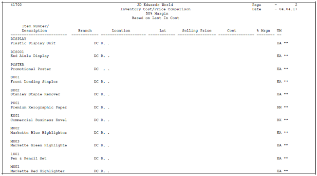

20.3 Reviewing the Margin Analysis Report
From Inventory Reports (G41111), choose Margin Analysis
Margin Analysis is a DREAM Writer report that you use to identify profit margin based on current information. This report allows you to periodically analyze your cost and price values. It also identifies margin exception items.
The Margin Analysis report retrieves records from the Item Cost Information (F4105) and the Item Pricing Information (F4106) tables.
The two asterisks (**) next to the unit of measure indicate that the margin percentage does not meet the minimum margin that you specified in the processing options.
Figure 20-3 Margin Analysis report
Description of Figure 20-3 follows
Description of "Figure 20-3 Margin Analysis report"

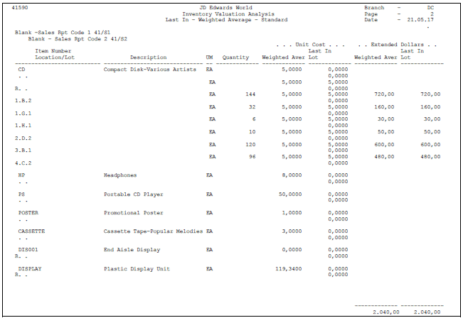

20.4 Reviewing the Valuation Analysis Report
From Inventory Reports (G41111), choose Valuation Analysis
Valuation Analysis is a DREAM Writer report that you use to review the extended value of on-hand inventory, based on the following cost bases:
  • Weighted average unit cost
  • Last-in unit cost
  • Lot cost (associated with each storage area for an item)
You can compare these costs to your inventory account or the inventory accounts in your general ledger.
You can create a version of this report using the G/L class code to produce totals that correspond directly to the accounts in your general ledger.
You must use the following data sequence:
  • Warehouse
  • Sales reporting code 1
  • Sales reporting code 2
Figure 20-4 Valuation Analysis report
Description of Figure 20-4 follows
Description of "Figure 20-4 Valuation Analysis report"

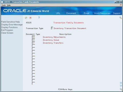

20.5.2 Grouping Transaction Types
From Inventory Reports (G41111), choose Transaction Family Documents
Before you run the Inventory Turn report, you must group your transaction types by document codes.
For example, you can group the transaction codes for inventory adjustments (IA), inventory issues (II), and inventory transfers (IT) into a transaction type for inventory transactions (I). You can then run the Inventory Turn report using "I" as a transaction family document type in the processing options.
To group transaction types
On Transaction Family Documents
Figure 20-5 Transaction Family Documents screen
Description of Figure 20-5 follows
Description of "Figure 20-5 Transaction Family Documents screen"
Complete the following fields:
  • Transaction Type
  • Document Type
Field Explanation
Transaction Type This field is used to locate different document transaction types such as I for Inventory Transaction documents, O for Purchase Order documents, and S for Sales Order documents.
Document Type A user-defined code (system 00/type DT) that identifies the origin and purpose of the transaction.
JD Edwards World reserves several prefixes for document types, such as vouchers, invoices, receipts, and timesheets.
The reserved document type prefixes for codes are:
P – Accounts payable documents
R – Accounts receivable documents
T – Payroll documents
I – Inventory documents
O – Order processing documents
J – General ledger/joint interest billing documents
The system creates offsetting entries as appropriate for these document types when you post batches.

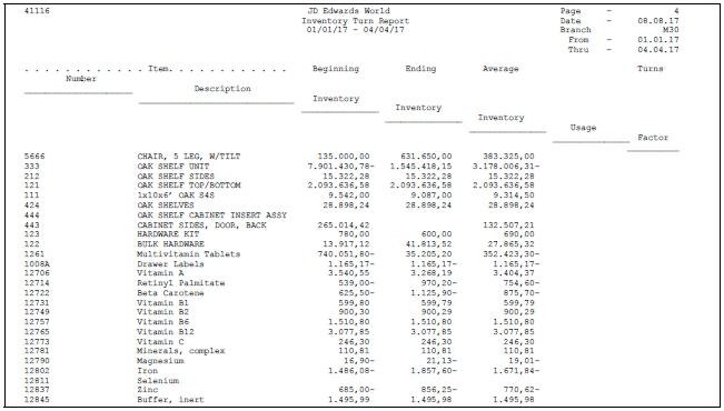

20.5.3 Running the Inventory Turn Report
From Inventory Reports (G41111), choose Inventory Turn Report
You can print this report for a cost center, an item, and a date range combination that you specify.
The Inventory Turn report:
  • Retrieves records from the Item Ledger table (F4111)
  • Clears the existing workfile, rebuilds it, and accesses records to produce the report
  • Transaction date
  • Branch/plant
  • Item number-short
Figure 20-6 Inventory Turn report
Description of Figure 20-6 follows
Description of "Figure 20-6 Inventory Turn report"
20.5.4 What You Should Know About
Topic Distribution
Columnar information The system calculates beginning, ending, and average inventory as follows:
  • Beginning inventory is the amount for all transactions prior to the first date that you specified in data selection.
  • Ending inventory is the amount of the beginning inventory plus or minus the amount of the item ledger transactions for the period that you specified in the processing options.
  • Usage is the amount of all the item ledger records that match the transaction family document types that you specify in the processing options for the report.
20.5.5 Processing Options
See Section 59.11, "Inventory Turn Report (P41116)"

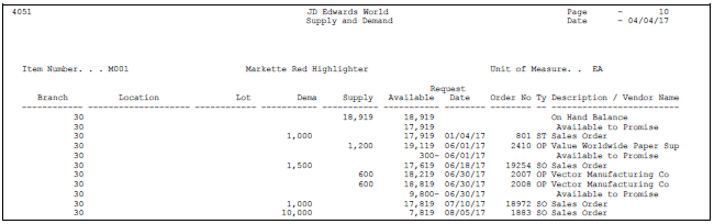

20.6 Reviewing the Supply and Demand Report
From Inventory Reports (G41111), choose Supply/Demand
Supply and Demand is a DREAM Writer report that provides information about an item's demand, supply, and available quantities. The report lists the following information:
  • Quantities on hand
  • Safety stock
  • Sales orders
  • Purchase orders
  • Forecasts
  • Work orders
You can print a report for supply and demand information using the following criteria:
  • Branch/plant
  • Item number
  • Date
20.6.1 Before You Begin
Figure 20-7 Supply and Demand report
Description of Figure 20-7 follows
Description of "Figure 20-7 Supply and Demand report"
20.6.2 Processing Options
See Section 59.12, "Supply & Demand Report (P4051)"
