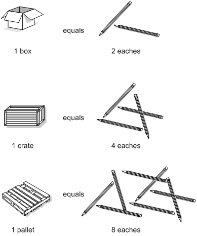

When you define standard units of measure, you can create any number of conversion factors for any number of units of measure. You can also set up conversion factors that associate each unit of measure with the primary unit of measure.
This program supports import/export functionality. See the JD Edwards World Technical Foundation Guide for more Information
1 box = 2 eaches
1 crate = 2 boxes
1 pallet = 2 crates
Figure 38-1 Example of Conversion Factors for Units of Measure
To determine the primary unit of measure, the system performs the following calculation:
Figure 38-2 Example of Primary Unit of Measure Calculation
